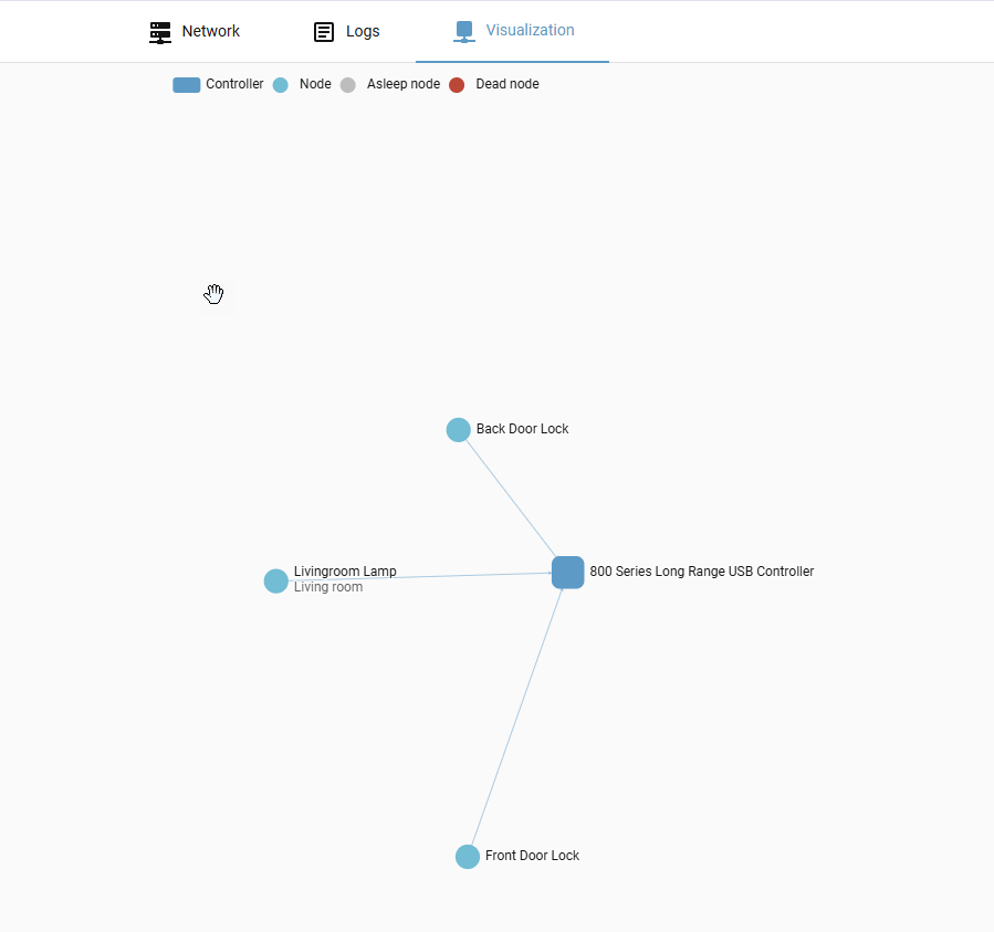

Missed actions indicate issues in your ZWave network. Have you tried repairing the routes from the device?
New to zwave. How?
I am seeing this for the routes.
