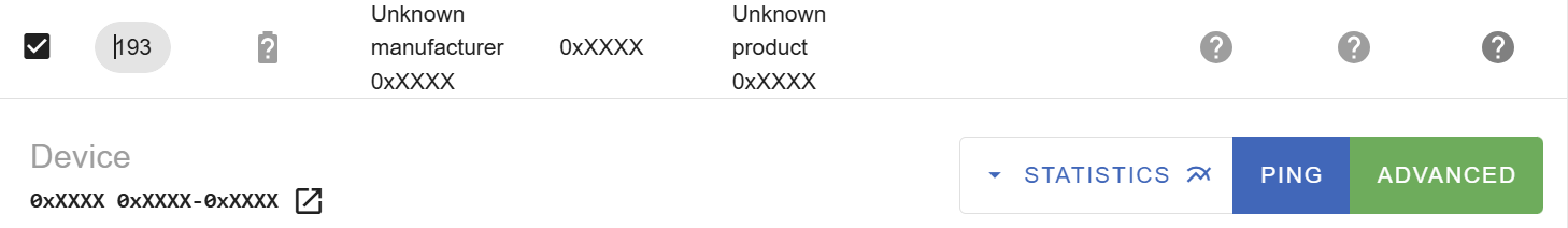

I had issues adding a new Zwave device and I tried both on HA App as on well on my computer. Finally I restarted HA and it worked, but in the meantime it was added 4 times to HA, of which only the last addition is good.
I went into Zwave JS UI and tried to remove the failed additions (see example) but I am not successful.
Any suggestion on how to remove these ?

Resolved.
HA was re-interviewing the failed devices, which took hours. The next morning I was able to remove the failed devices.
