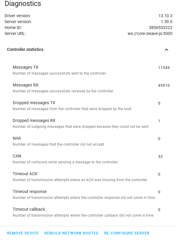

I’m wondering if this has something to do with errors on the Zwave network? I looked at my Zwave controller statistics and they seem ok, but I have no experience troubleshooting this. Does anyone have any advice on how I can troubleshoot? I really need to make sure my leak detection is bulletproof.
1 error is likely unrelated
Errors are more likely to prevent function not cause function
