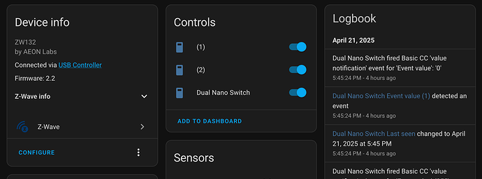

I wasn’t 100% sure where you were referring to, but believe you’re talking about the device details when clicking on the zwave entity of the device. When I click on the zwave device for the ‘dual nano’ I get what I believe is the screen you’re referring to, and as I tried to explain, under control section. the two switches need to stay on always so the wifi bulbs always have power They are switch.devices (two sub devices hence the dual nano like. switch.dual_nano_switch_1 and switch.dual_nano_switch_2). I have them divorced from the dumb switch through the z-wave JS UI configuration section and instead of switching the ‘load’ (aka turning on/off the relay and therefor power) to the lights it is set to just send a notification that I can use to trigger a light group to turn on/off (the 6 Lifx wifi flood lights).
So, when I throw the dumb switch, it tells the duel nano that it was turned ‘on’ but the relay is already on and stays on regardless of the dumb switch position. But what it does do is send some messages. To MQTT and to HA.
Again, when i was fixing the mqtt trigger because of the change to the mqtt message, I stumbled across the event device ID that was actually sending/tracking the value change from off (0) to on (255) as a discrete entity and thought it would be simple to just switch to that as the trigger. Clearly not.
event.dual_nano_switch_event_value_1 and event.dual_nano_switch_event_value_2 exist but HA just tracks that an ‘event’ happened. but within that even the a ‘value’ is updated to 0 or 255.
