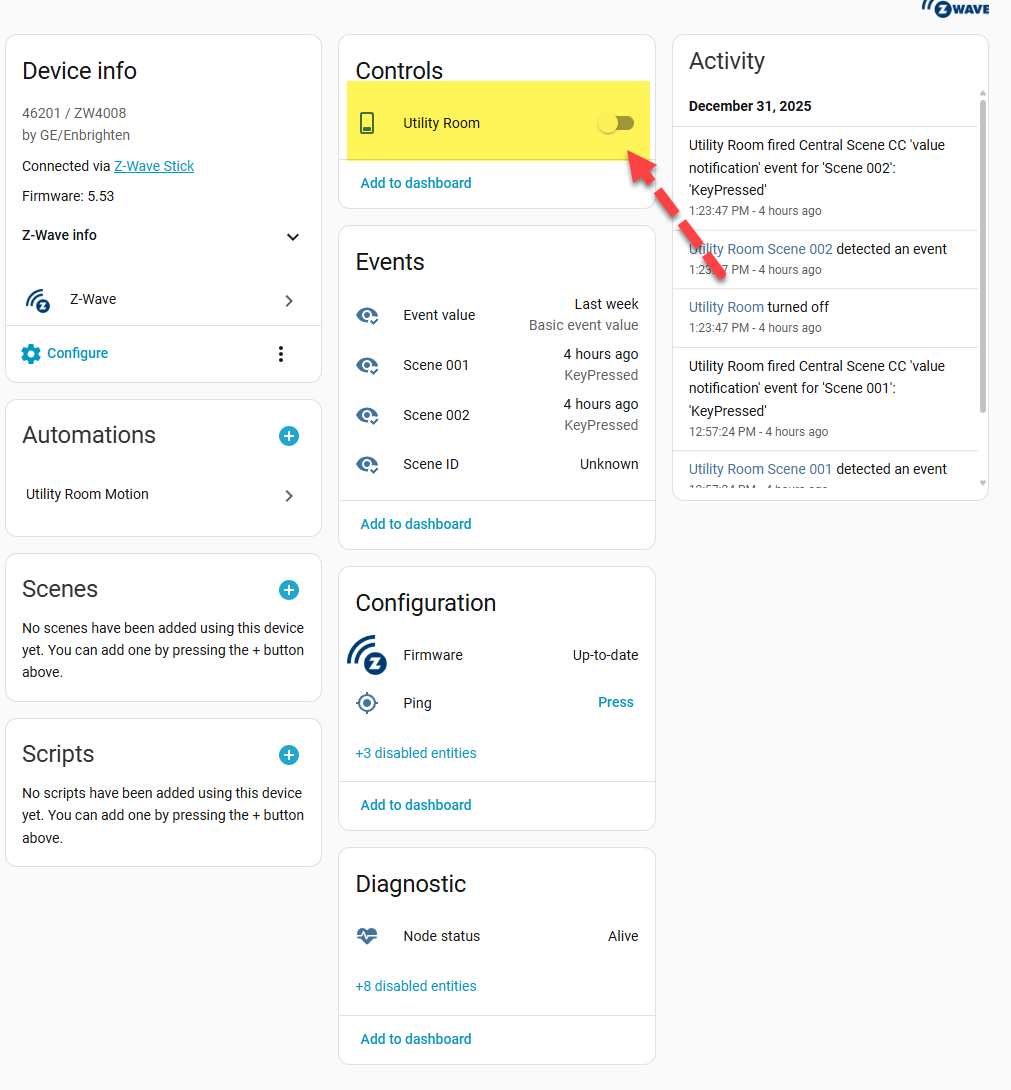

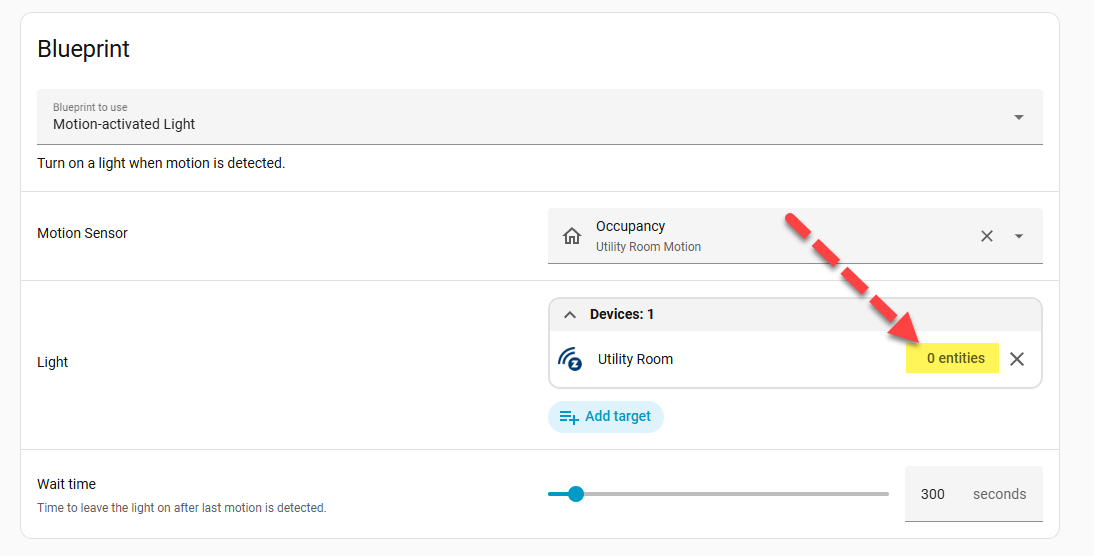

Yet when I select the Z-Wave switch device it states that there are 0 entities…the switch has been in place forever and I can control the switch from my dashboard with no issue…yet when creating the automation it does not seem to exist!
What am I doing wrong??
Here’s the switch from the Zwave integration

How can you be so sure? Your blueprint says “Light”, but you are trying to select a switch. Does the blueprint support switch entities or is it simply restricted to lights?
It’s not immaterial.
The blueprint seems to be looking for a light based on the description. You want to use a switch entity & it’s telling you there are no light entities for your device.

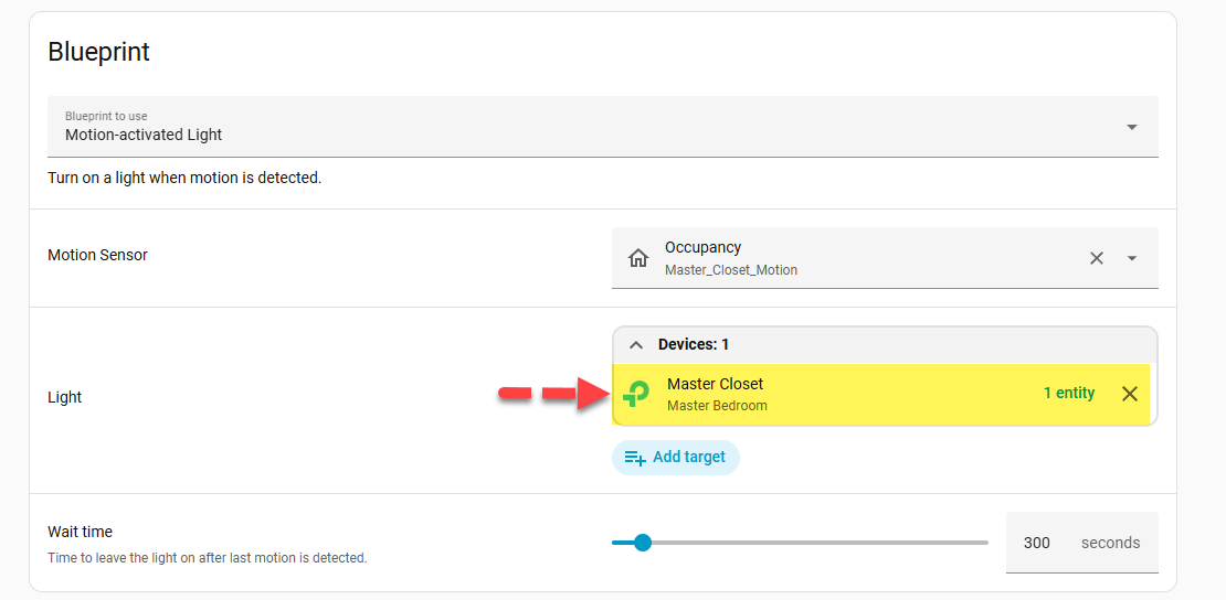

I’m using the same blueprint with another switch and it’s working as intended.
The only difference is it’s a KASA switch not a Zwave switch.
