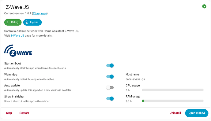

The normal / internal version is now the “UI” version since 1.0.0. They have been combined. If you look at the App, you’ll see a button to open the UI.
BTW, you have to have both an “App” and “Integration”. The App is what talks to the Z-wave controller hardware. The integration talks to the App using Websockets. This has always been the case, just the old “internal” App had no UI. In contrast, the internal Zigbee integration (ZHA) talks directly to the coordinator hardware, no App needed.
