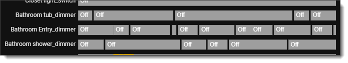

For the unavailable issue, rebooting has not solved anything (tried multiple times), nor has any of the updates. I see disconnects/dead devices such as following, which is a 90 min capture (black lines indicate dead device).

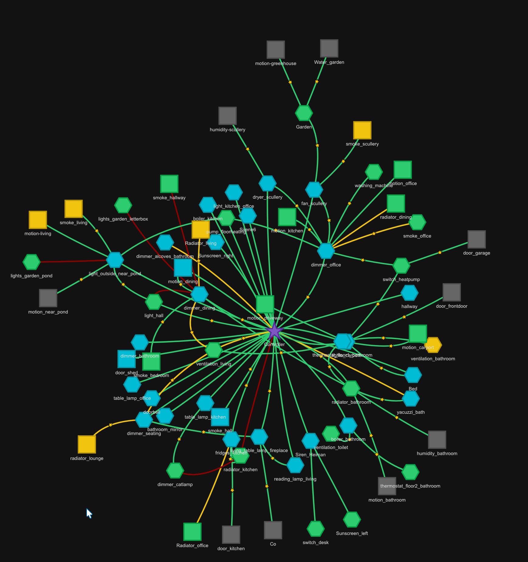

The ZWA-2 seems a bit more stable but not significant. Since the summer It appears that nodes spontaneously forgot their neighbors from time to time. Some sensors drop ‘dead’ and most sensors become ‘unknown’ in the zwave-js graph. So I spend a couple of hours by forcing powered nodes to find neighbors and setting priority routes. The effect is that most nodes will find their way afterwards and the network becomes responsible again.
This is after manually having devices discover their neighbors. Still lots of grayed devices ('unknown) and some red lines. What has happened this summer? Does this have a relation to the introduction of the long range bullshit that throws the whole mesh principle away? (If you want long range, choose lora instead please)
