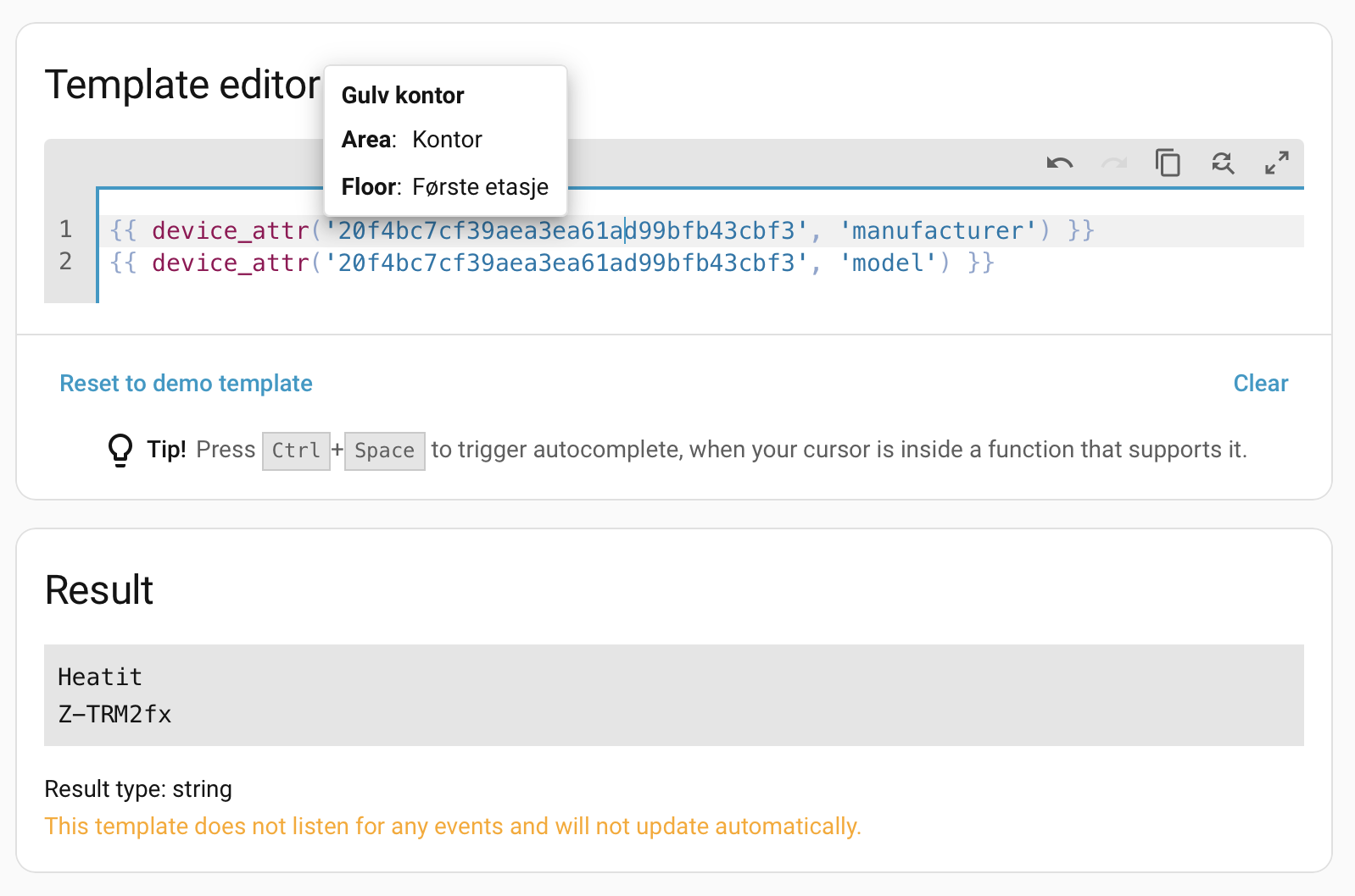

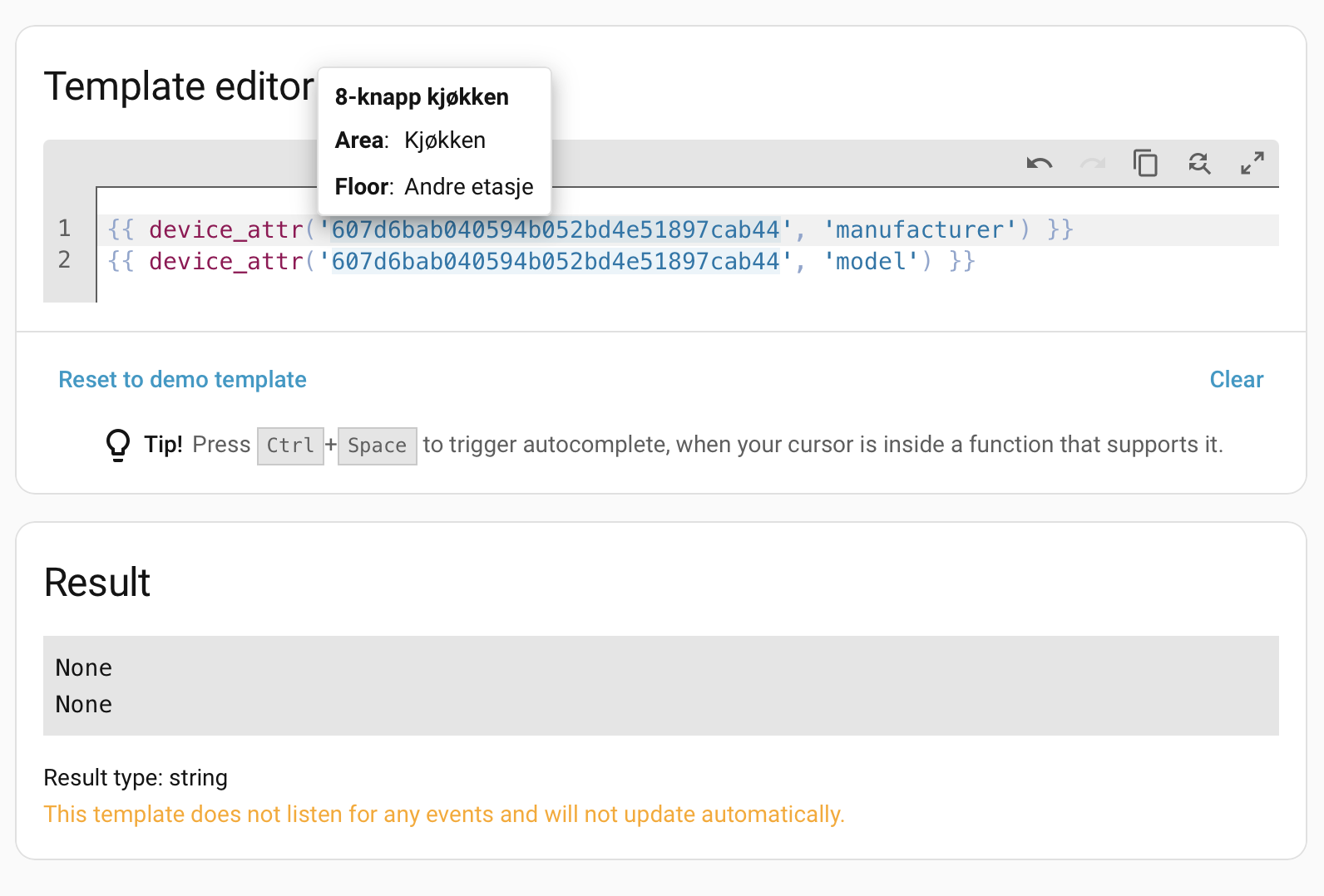

24
I tried entering the device name directly like this, still None/None:
Another example:
