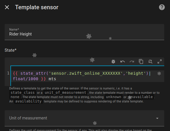

You can create a template sensor in the menu “settings → devices & services → Helpers → Create helper → Template → sensor”
then you can use the look for the information convert it to float and divide by 1000. And add mts add the end.
Replace the XXXXXXX with your <playerid>

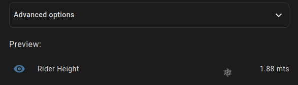

it will get you something similar to this (with your height) then you can use this sensor in your boards
Good Luck!!

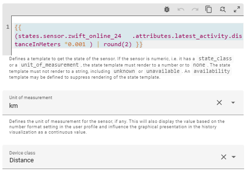

I do mine a little different but the results are the same - this is different example for last ride distaste
{{ (states.sensor.zwift_online_24xxx.attributes.latest_activity.distanceInMeters *0.001 ) | round(2) }}

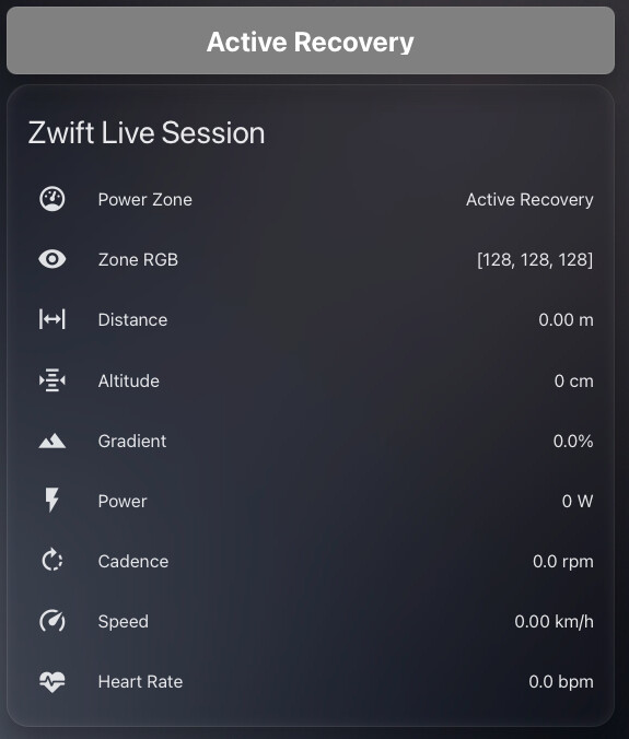

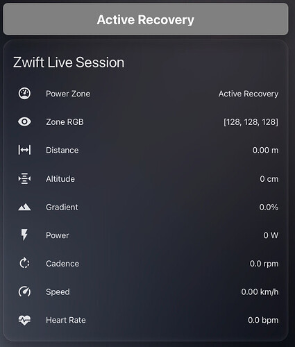

I didn’t find any docs, but it looks like sensor.zwift.activity.colour takes the colour attribute from light.zwift_<profile_name>_power_zone_color. Then we qpply this RGB sensor value to our RGB lights - is that the idea?
yeah, that was the idea, @Maddimax may be able to better explain how its being used. It may be worthwhile to make this light entity optional.

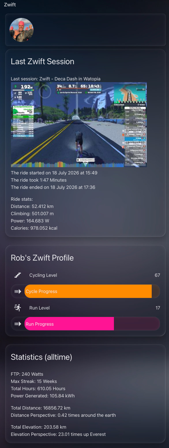

Got it. Card’s looking good.
Then “Last Zwift Session” get’s replaced with “Zwift Live Session” using conditional cards (state “Zwift Online”)
The colour bar dynamically track the state of sensor.zwift.activity.colour and sensor.zwift_<profile_neme>_power_zone_name.

As promised @nebulight. Yaml below
Sensors/entities used:
image.zwift_<user_name>_profile_picture
sensor.zwift_online_<uniqueID_number>
sensor.zwift_<user_name>_power_zone_name
sensor.zwift_activity_color
sensor.zwift_distance_<uniqueID_number>
sensor.zwift_altitude_<uniqueID_number>
sensor.zwift_gradient_<uniqueID_number>
sensor.zwift_power_<uniqueID_number>
sensor.zwift_cadence_<uniqueID_number>
sensor.zwift_speed_<uniqueID_number>
sensor.zwift_heart_rate_<uniqueID_number>
sensor.zwift_level_<uniqueID_number>
sensor.zwift_cycle_progress_<uniqueID_number>
sensor.zwift_run_level_<uniqueID_number>
sensor.zwift_run_progress_<uniqueID_number>
sensor.distance_earth_circumference
sensor.elevation_mountain_everest
Cards used:
custom:layout-card
custom:button-card
conditional
markdown
entities
custom:bar-card
Main Last/Live Sessions (conditional)

and finally the global stats cards
type: custom:layout-card
layout_type: vertical
cards:
  - type: markdown
    title: Statistics (all-time)
    content: >-
      FTP: {{
      states.sensor.zwift_online_<uniqueID_number>.attributes.ftp
      }} Watts
      Max Streak: {{
      states.sensor.zwift_online_<uniqueID_number>.attributes.streaksMaxLength
      }} weeks
      Total Hours: {{
      states.sensor.zwift_online_<uniqueID_number>.attributes.totalTimeInMinutes
      / 60
      ) | round(2)
      }} hours
      Power Generated: {{
      states.sensor.zwift_online_<uniqueID_number>.attributes.totalWattHours
      / 1000
      ) | round(2)
      }} kWh
      Total Distance: {{
      states.sensor.zwift_online_<uniqueID_number>.attributes.totalDistance
      / 1000
      ) | round(2)
      }} km
      Distance Perspective: {{
      states.sensor.distance_earth_circumference.state
      }} times around the Earth
      Total Elevation: {{
      states.sensor.zwift_online_<uniqueID_number>.attributes.totalDistanceClimbed
      / 1000
      ) | round(2)
      }} km
      Elevation Perspective: {{
      states.sensor.elevation_mountain_everest.state
      }} times up Everest
associated template sensors (two of) for above:
- sensor:
    # Various sensors for the Zwift dashboard
    - name: "Distance Earth Circumference"
      default_entity_id: sensor.distance_earth_circumference
      unit_of_measurement: "times around Earth"
      state: >-
        {% set total_distance_travelled_km =
        | float(0) / 1000 %}
        {% set earth_circumference_km = 40075 %}
        (total_distance_travelled_km / earth_circumference_km)
        | round(2)
    - name: "Elevation Mount Everest"
      default_entity_id: sensor.elevation_mountain_everest
      unit_of_measurement: "times up Everest"
      state: >-
        {% set total_distance_climbed_meters =
        | float(0) %}
        {% set everest_height_meters = 8849 %}
        (total_distance_climbed_meters / everest_height_meters)
        | round(2)
Love this integration.
