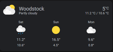

The new weather card is very odd. On my smaller tablets it only shows three days. But on my laptop it will show five days. Also I notice that if it is going to rain it does not show the amount below the day anymore.
Small Tablet View:
Laptop View:

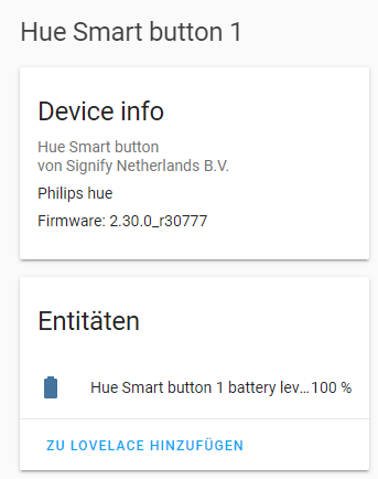

So it seems that Philips Hue Smart Buttons are now supported, but I can only see their battery levels, not button clicks. How can I fix this?
2020-05-02_21h43_50
Check for events
