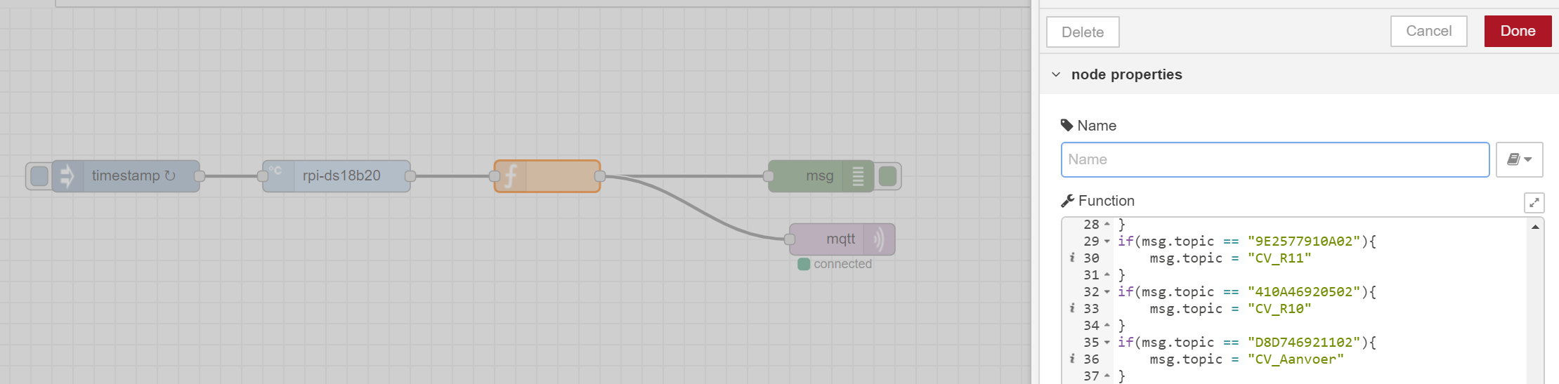

I use ds18b20 sensors connected to a rpi with node red. Node red also calculates the delta temps and sends the readings over MQTT. Besides that node red converts the serial number of the sensor to a meaningful name.

The node-red flow is faily simple:
