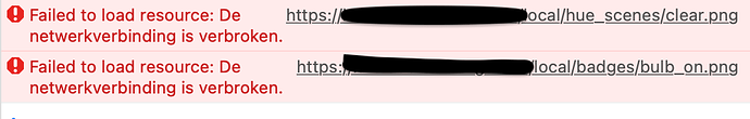

anyone else noticing frequent network issues lately, I believe since 2021.5.2?
these errors are frequently showing, and all point to images in my www folder:
and have not changed since a couple of years :wink: I’ve enlarged some of them (not these btw) to make the pinchable, but hardly believe size matters in here?
Do believe it is mostly Safari, my Chrome browser and the App show fine, where Safari blanks on these images (used on custom card Button).
