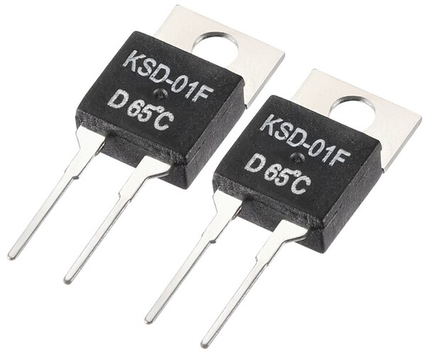

I do not run my HA in a RPi , but i have Octoprint.
My solution for the cooling was a KSD-01F Temperature Switch. It is a hardware solution and it has been working for a couple of years now without any problems.
I just screwed the switch to a cooling block for the RPi CPU and glued it on there.
