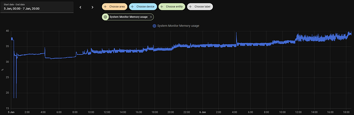

I have now enabled all memory and cpu sensors and will track them im parallel.

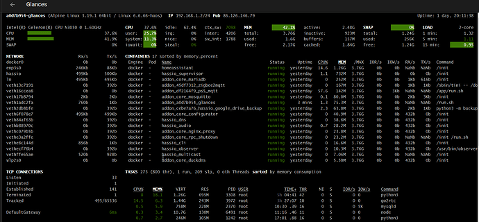

Here we go. VSC. The addon takes now more than more memory, never releases it back, add even more on re-opening it. Only add-on restart brings the memory back. The whole system gets otherwise more and more unresponsive, most probably because of memory swapping, etc. Including automatic system-hard-reboots, …
Here a start of the VSC UI. 40%. And Core (blue) and Supervisor (green) got swapped to disk I think. Orange is total up to over 95% what is ofc not healthy for the stability.
I seems to be only vscod-addon ans surprisingly it seems a known problem here, here or here.

Did try to change the templates, but I keep experiencing the memory leaks.
Here is what I captured.
I didn’t include the first entry items, not sure if it is important to view those (e.g., dict had 232,627; list 105,698 ).
Anything that I should look for?
