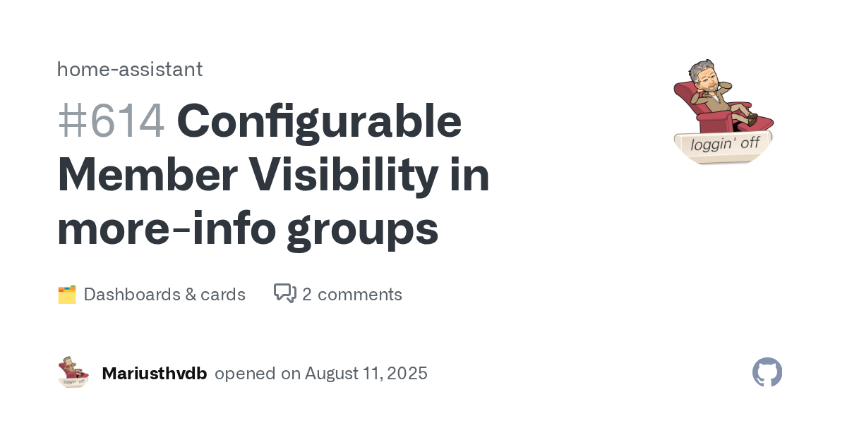

Totally understand and I am not being difficult. I do agree with @Mariusthvdb on this though. Grouping was to simplify my dashboards. In my kitchen, I have 48 Hue bulbs. These are grouped by area and now my more info for the downlights alone has a list of 24 different entities that makes my dashboard extremely long vertically. I would also request being able to swtich these on and off by user choice. I can create a lighting group within HA for this and hide members but I already have the lighting group coming through from Hue. Being given the option to show/hide would be really nice. @Mariusthvdb, would you share the location of the FR so I could review and add to it? Thank you
note there is also Show the state of individual group members in the "more-info" dialog of the group · home-assistant · Discussion #39 · GitHub :wink:
