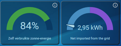

since the last 2 updates…we have this problem
the name of this gauge should be in my languange like all others…

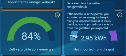

second >>>
the part if ya hover over it doesn’t do it eighter!

Translations are provided through lokalise (documentation here). If some elements are not translated it usually means nobody has contributed a translation yet for that language. You can contribute missing frontend translations here.
If it used to be translated in an older version, the source string probably changed and so a new translation needs contributing.
