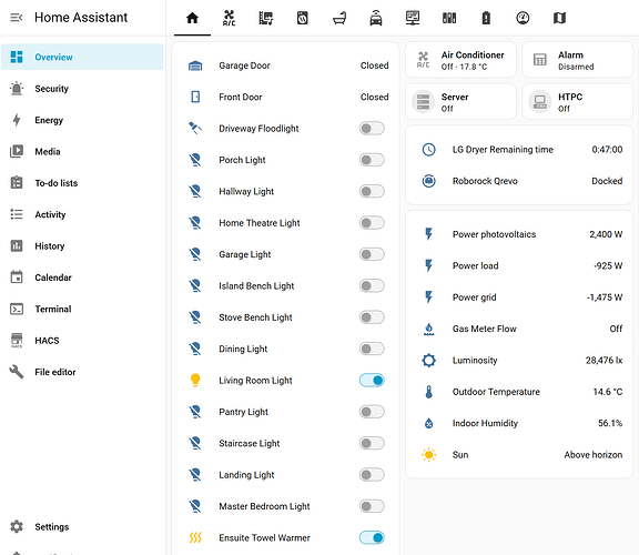

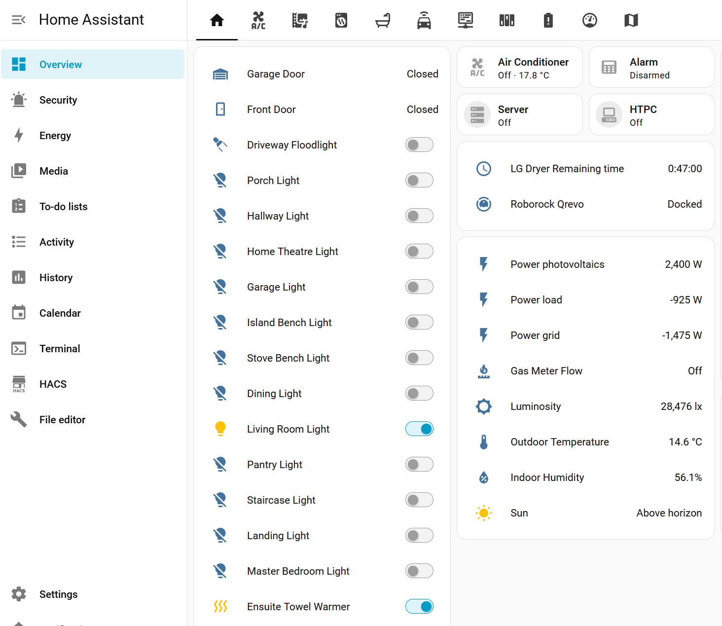

I am going to chime in here as well.
Firstly - thanks to all the hard work HA team, we do appreciate it, and I love home assistant.
Now on to the toggles. I got a bit of a shock when I installed 2026.5. I thought all of my switches had turned ON.
I don't mind the dev's making style updates but this is a step backwards for me.
The toggles now...
  1. Are too dark and in your face when they are in the OFF state.
  2. If you had a no colour display (a common requirement for human machine interfaces to account for both monochrome and colour blindness) the off state looks identical to the ON state, e.g. the contrast grey-scales are the same.
  3. Do not match any of the rest of the default theme. This is a new dark grey not used anywhere else.
I applied a slight de-tune myself to tone down the greys of these toggles to match the off state of the other default tile and grid cards. Look at Server and HTPC for e.g. You will see they now all match and don't look so ON.
If this the style HA want to pursue then I would recommend this detune, and of course please align right (rather than left these toggles) as mentioned by others.
  #Toggle Switch tame colours when disabled (since 2026.5)
  # OFF thumb only
  ha-switch-thumb-background-color: "#9e9e9e" #Lighter Grey Thumb
  ha-switch-thumb-background-color-hover: "#5e5e5e" #Default Grey on Hover
  # Subtle border
  ha-switch-thumb-border-color: "#9e9e9e" #Lighter Grey Border
But to be honest the old style was even better, as OFF did not grab your attention while ON did, which makes looking at pages at a glance to see important information quicker and clearer.

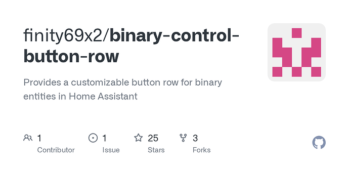

For people that search alternative style:
There are more repo from the owner for lights, . Available via HACS.

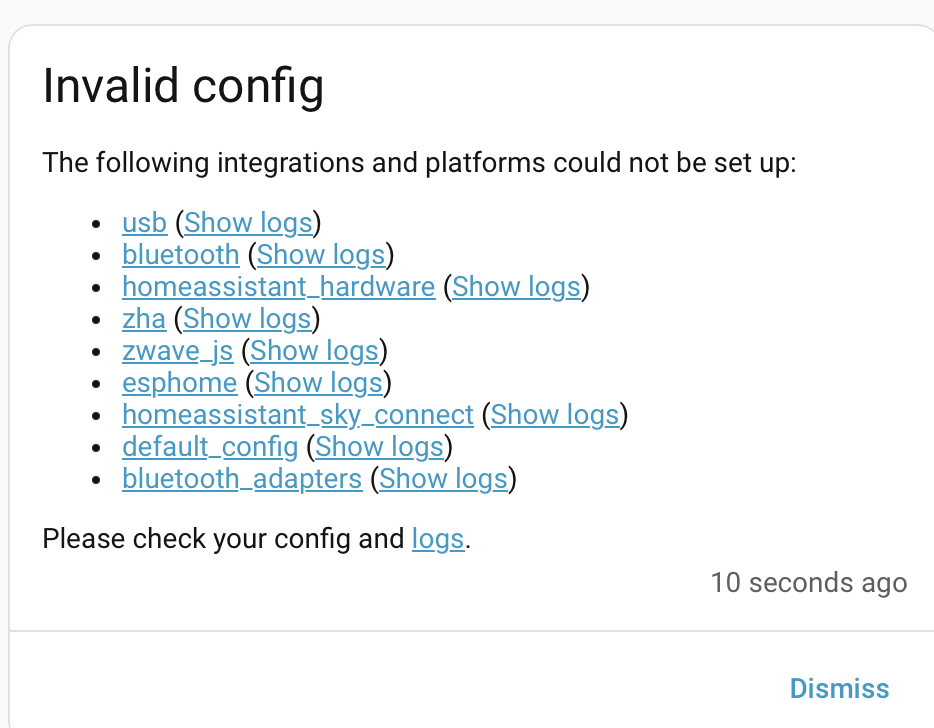

Getting lots of errors with this one. Going back to 2026.4
Logger: homeassistant.setup
Source: setup.py:255
First occurred: 11:09:35 AM (7 occurrences)
Last logged: 11:09:51 AM
  • Unable to set up dependencies of 'zwave_js'. Setup failed for dependencies: ['usb']
  • Unable to set up dependencies of 'zha'. Setup failed for dependencies: ['homeassistant_hardware']
  • Unable to set up dependencies of 'esphome'. Setup failed for dependencies: ['bluetooth']
  • Unable to set up dependencies of 'homeassistant_sky_connect'. Setup failed for dependencies: ['usb', 'homeassistant_hardware']
  • Unable to set up dependencies of 'default_config'. Setup failed for dependencies: ['bluetooth', 'usb']
