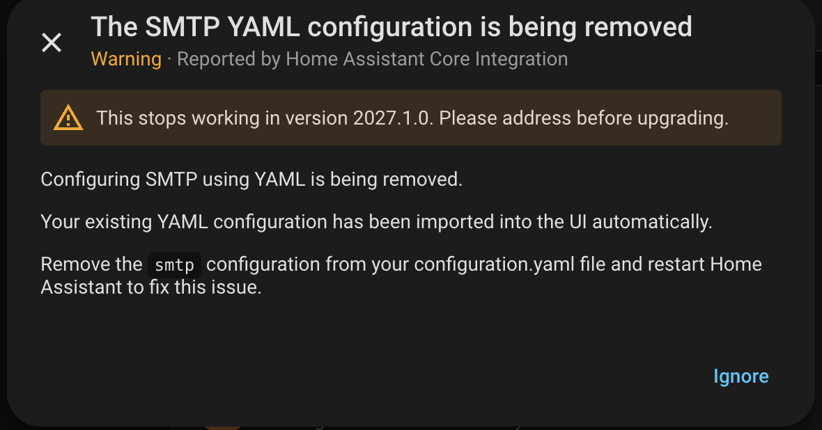

There's something really odd with this update. I get repeated warnings that I should remove smtp from configuration.yaml...I have no smtp set there...or anywhere AFAIK? Unless they mean platform: smtp in notify?

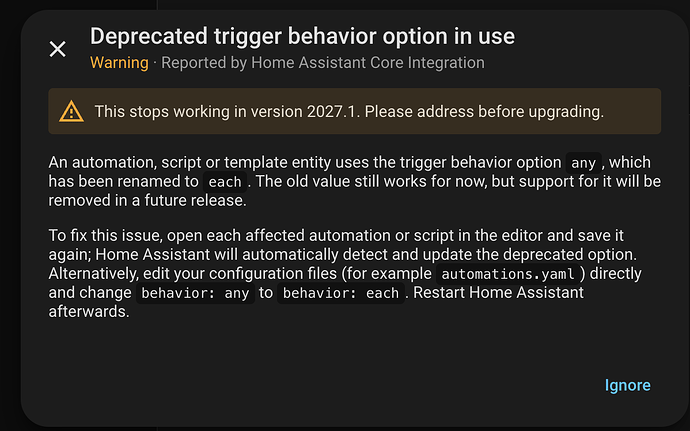

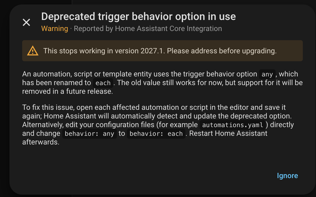

And I changed the behavior: any to behavior: each as requested as it will be deprecated in 2027.1, and it broke those automations and I was instructed in the Automations to set it back to behavior: any!
Weird error about 'null' not accepted by behavior in the messages, and then in the Automation itself a red bar saying that only any or all are accepted, and to click here to change it back....
Yes I have restarted many times.
Like...which is correct? Seems like the two systems are fighting each other...

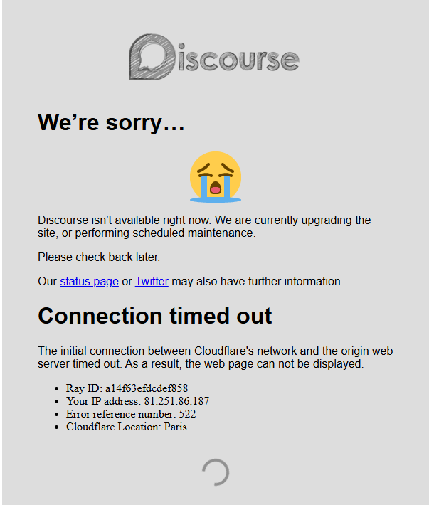

Same here, I have logs saying 'https://wheels.home-assistant.io/' is not reachable. I guess that's the problem. Anyone else have the same logs?
Three in the case of Conditions & Actions
yes https://wheels.home-assistant.io is down and it breaks the update :disappointed_face:
And yes just checked - if I resave the automation as requested in the alert - then look at the yaml - it says behavior: any not behavior: each
