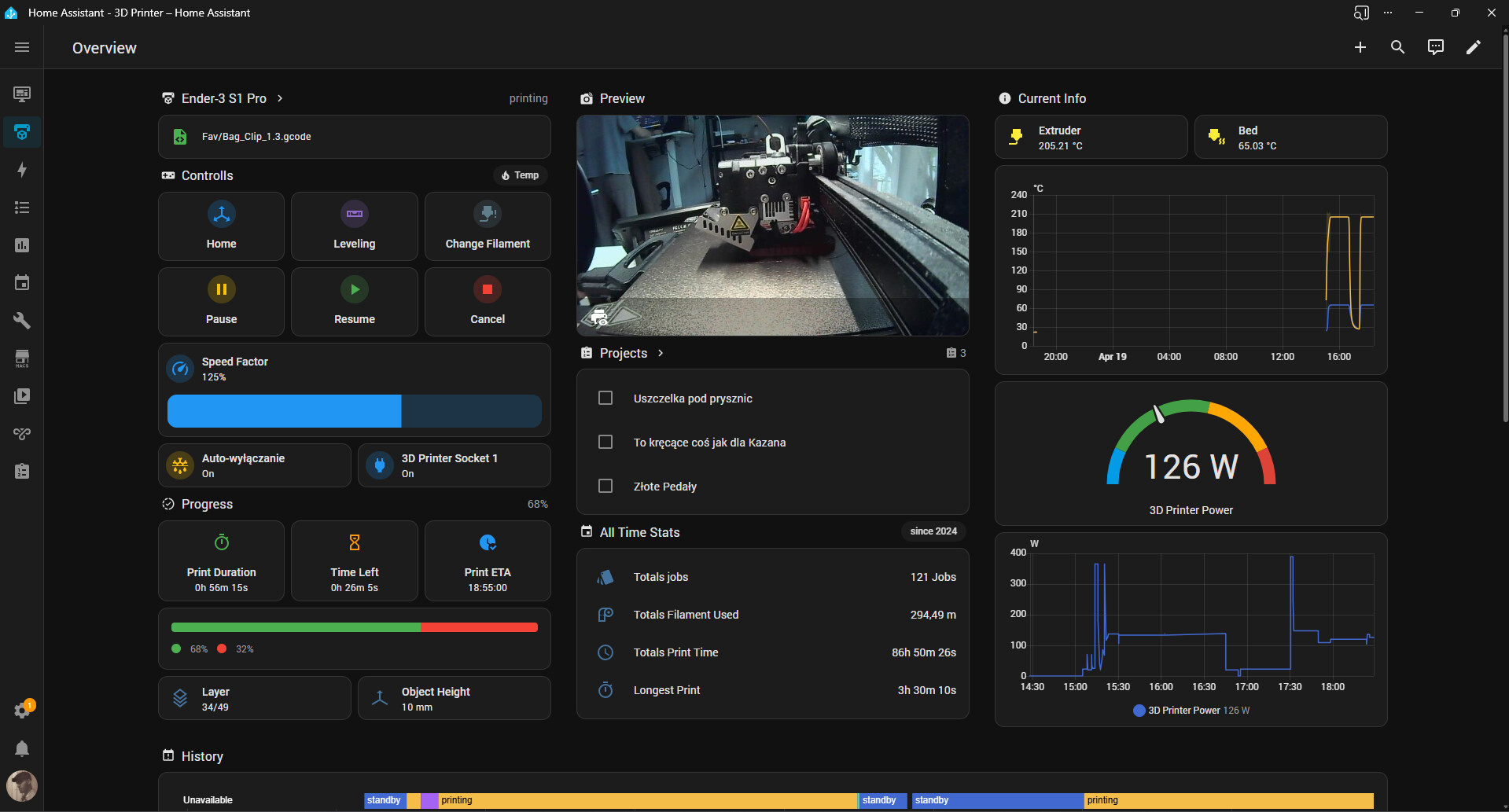

Sure, no problem. There is a lot of entities that will need renaming. Probably easiest to do some ‘search and replace’ in notepad or something.
This is the main printer part (Left side)
Main printer code
type: vertical-stack
cards:
  - type: custom:mod-card
    card:
      type: custom:mushroom-chips-card
      chips:
        - type: template
          entity: binary_sensor.x1c_00m09d470100819_online
          icon: phu:bambu-lab
          card_mod:
            style: |
              ha-card {
                background: none !important;
                border: none;
                font-size: 4rem !important;
        - type: spacer
        - type: entity
          entity: sensor.x1c_00m09d470100819_current_stage
        - type: light
          icon: mdi:lightbulb
          entity: light.x1c_00m09d470100819_chamber_light
        - type: entity
          entity: binary_sensor.x1c_00m09d470100819_hms_errors
          icon: mdi:alert-circle
    card:
      camera_view: live
      type: picture-glance
      entities: []
      camera_image: camera.x1c_00m09d470100819_camera
  - type: horizontal-stack
    cards:
      - type: custom:button-card
        color: green
        color_type: icon
        entity: button.x1c_00m09d470100819_resume_printing
        icon: mdi:play
        layout: icon_name
        card_mod:
          style: |
            :host {
                --paper-item-icon-color: green}
            ha-card {
              height: 60px;
          layout: icon_name_state
        color: "#C46641"
        color_type: icon
        entity: button.x1c_00m09d470100819_pause_printing
        icon: mdi:pause
        card_mod:
          style: |
            :host {
                --paper-item-icon-color: darkorange}
            ha-card {
              height: 60px;
        confirmation:
          text: "[[[ return `Pause the print?` ]]]"
        color: rgb(255, 0, 0)
        color_type: icon
        entity: button.x1c_00m09d470100819_stop_printing
        icon: mdi:stop
        card_mod:
          style: |
            :host {
                --paper-item-icon-color: red}
            ha-card {
              height: 60px;
        confirmation:
          text: "[[[ return `Stop the Print?` ]]]"
    cards:
      - camera_view: auto
        fit_mode: cover
        entities: []
        image_entity: image.x1c_00m09d470100819_cover_image
        hold_action:
          action: none
      - type: vertical-stack
        cards:
          - type: markdown
            content: >-
              <font size="4">{{
              states.sensor.x1c_00m09d470100819_task_name.state }}</font>
              <table width=100%><tr><td align=left>Printed layers<td
              align=right><font color=#C46641 ; size="4">{{
              states.sensor.x1c_00m09d470100819_current_layer.state}}</font>/{{states.sensor.x1c_00m09d470100819_total_layer_count.state}}</td></tr></table>
              <table width=100%><tr> <td align=left><font
              size="5";color=#C46641>{{
              states.sensor.x1c_00m09d470100819_print_progress.state}}%<td
              align=right>    {% if
              (states.sensor.x1c_00m09d470100819_remaining_time.state | float(0)
              * 3600) <= 0 %}
                Success
              {% else %}
                <font color=#959595>-{{ (states('sensor.x1c_00m09d470100819_remaining_time') | float(0) * 3600) | timestamp_custom('%-H:%M', false) }}
              {% endif %} </td> </tr></table>
          - type: custom:bar-card
            icon: "off"
            positions:
              icon: "off"
              indicator: "off"
              title: inside
              value: inside
            severity:
              - color: null
                from: 0
                to: 100
            entities:
              - entity: sensor.x1c_00m09d470100819_print_progress
The top of the right side, just above the AMS (Right side)

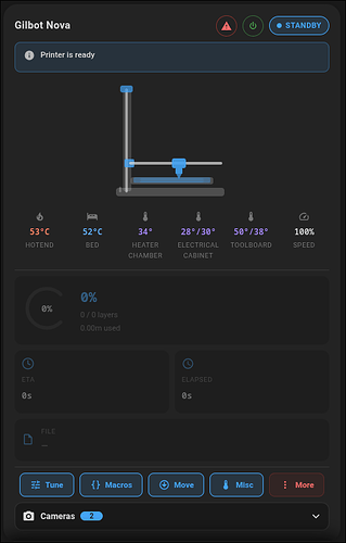

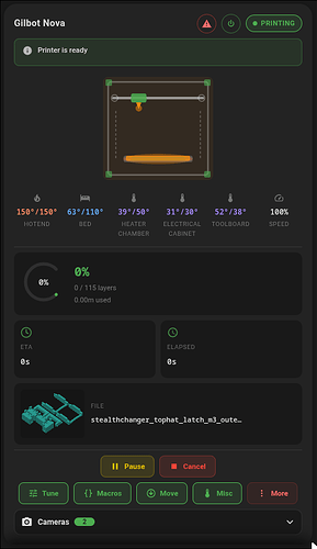

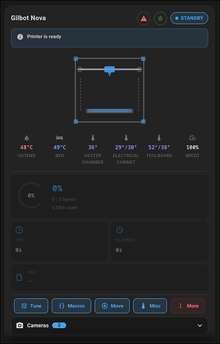

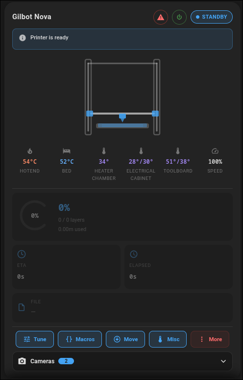

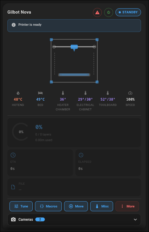

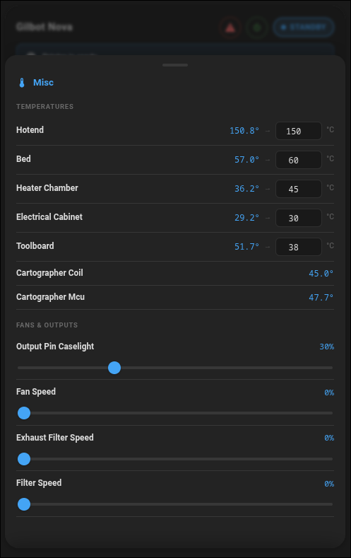

i recently created my own card for lovelace. Its a work in progress and any contribution is welcome. this is what it looks like as of today:
https://github.com/gilbertorconde/lovelace-3d-printer-card
also have other printer types:
@CondeGil amazing ! Can you add support for obico ml print failure detection (api and selfhosted server) perhaps? This is so cool! No frills setup simple stupid. Amazing.

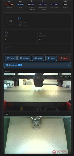

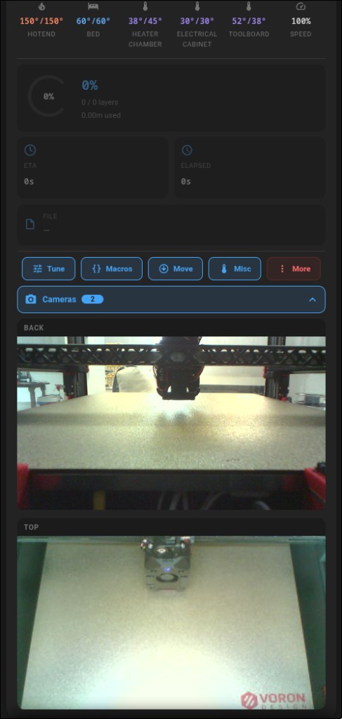

I’d like to share my current dashboard setup. The data is pulled from my Ender-3 S1 Pro via the Moonraker integration.
The interface is built entirely using standard Home Assistant and Mushroom cards, keeping it clean and straightforward. I’ve also included an Activity card at the bottom (though it’s tucked away out of immediate view).
One of the more interesting features: the Extruder and Bed icons dynamically change color based on their power consumption.
This is pretty cool , @KIVVI64, well done!
Can you share your configuration?
