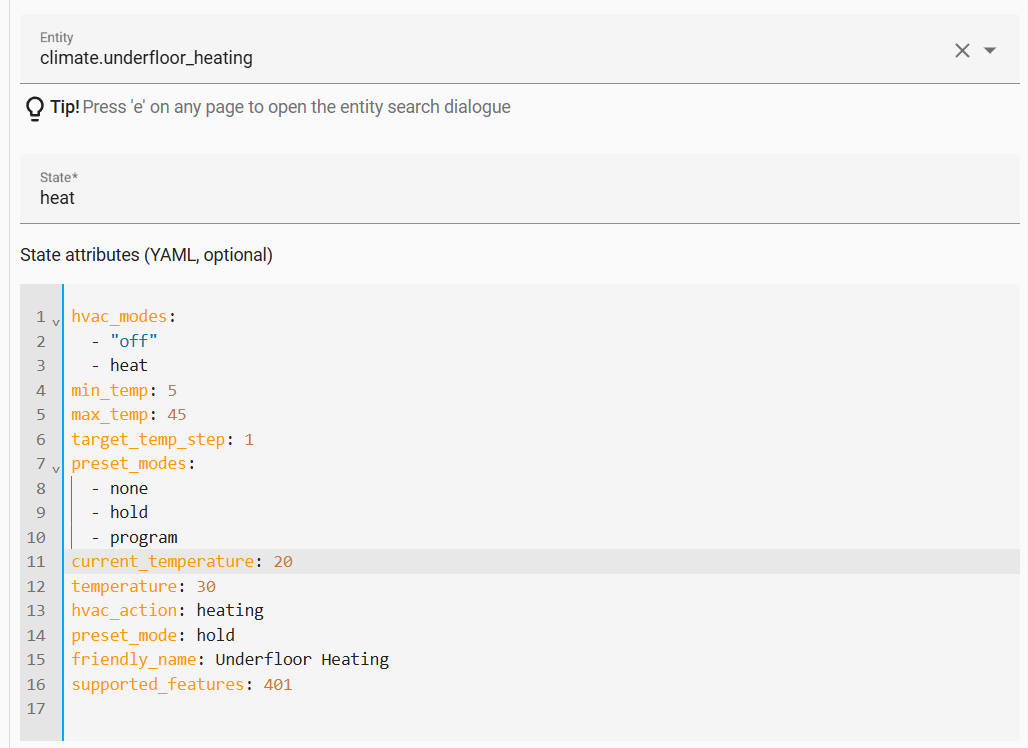

Hello, for an air conditioner this “current_temperature” is the room temperature, not the “set” temperature, is that right? How to I read the “set temperature” of an air conditioner?

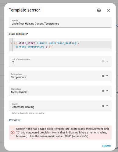

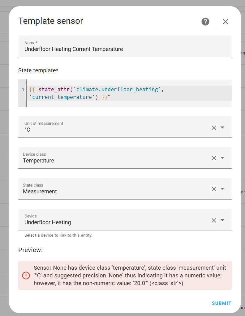

I’m trying to set up a Temperature sensor, but getting a String vs Number error - can anyone advise?
edit. I’m a plonker - stray quote
