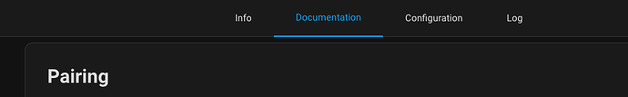

where is this option? i dont see it here
i have this but its not working
You’re looking in the wrong place, plus the property should be named legacy_action_sensor. You should undo your changes and follow the below steps:
