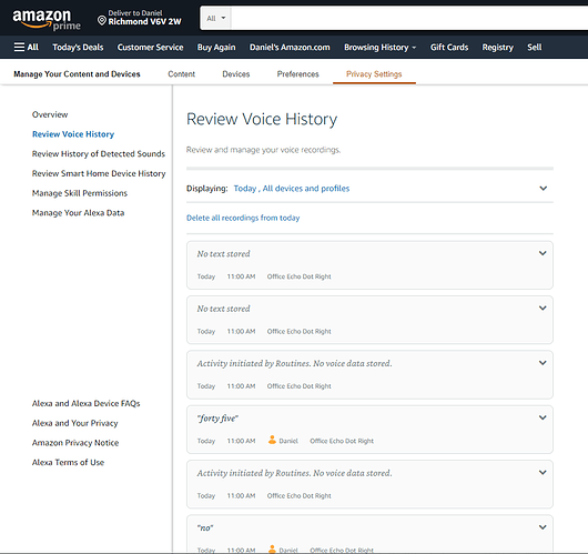

Yeah I did that earlier today and it says I’m on V0.7.2
It does have the ResponseNumeric implemented but I can’t be sure it actually worked since this is the first time I’ve tried it.
I’ll get t updated to the latest and see if that fixes it.
Now I just have to make sure I don’t break it completely. :laughing:
Is it useful to update lambda.py with this latest one even the whole config is working normal?
I didn’t update the script for a long period.
In this particular case I would say if it ain’t broke, I don’t see the need. There’s no new features that I can see. For me, I try and keep everything current. If you do update, keep a copy of the one you have…
Well, I completely updated the skill on the Amazon Dev site to the latest and greatest and still no joy.
The skill now recognizes every response I tried (yes, no, none) except for a numeric response.
On each of the yes and no I get “Okay” as expected. On none I get a little notification sound (like blub) as it recognizes no response.

but when I use a number I immediately get the little blub sound (exactly like no response) and the light ring stays active for a few seconds then just shuts off. No event is recorded. Between the two ResponseNone events above I tried a number response and it didn’t register.
Things seem to be better after the upgrade tho. So I think there is a bit of progress. But just not on the numeric response.
I’m at a total loss now.

here is the voice data:
Screenshot 2022-08-15 143534
Apparently it can’t understand me when I said 500. But listening to the audio it was clear as day.

Check this guide:
Most of it is very generic and I don’t think will fix this weird issue but you never know. I’m thinking the soft reset to get latest firmware wouldn’t hurt…
oops. I was looking at the wrong skill in that screen shot.
I do have intents there but they are the built-in intents but don’t include a number intent.
How do I add that intent?
incoming…done
Intents, Add Intent, Custom
Create a new slot: Name: Number, +, Slot Type: AMAZON.NUMBER (Mine is AMAZON.FOUR_DIGIT_NUMBER although I have said “four five six three eight seven” and received “456387”
I also see that I have these Slot Types:
Your audio works with my skill…
That’s good to know. Thanks for testing it.
I’ll try adding the intent and see where that gets me.
Here’s hoping…:crossed_fingers:

The problem remains for the ResponseTime. The get_intent_name() function always return “string” when I try to say a time (i’m trying in Italian)
I’m making some progress…
I figured out the reason I didn’t have the intents was because I was missing the intents under the JSON handler section. I added that and now both numbers and strings are recognized.
I’ve tried various number combinations using mostly natural speech (five hundred, seven forty five, etc) and one numeric string (0-7-5-2) and it’s kind of hit and mis whether the script recognizes the utterances as numbers or strings.
Here are examples:
All natural language (truncated to useful info only):
    "event_type": "alexa_actionable_notification",
    "data": {
        "event_id": "actionable_notification_response_numeric_test",
        "event_response": "945",
        "event_response_type": "ResponseString"
Event 3 fired 1:05 PM:
    "data": {
        "event_response": "800",
Event 2 fired 1:04 PM:
    "data": {
        "event_response": "842",
Event 1 fired 1:03 PM:
    "data": {
        "event_response": "736",
Event 0 fired 1:03 PM:
    "data": {
        "event_response": "500",
these are all with spoken individual numbers:
    "data": {
        "event_response": "2",
Event 3 fired 1:09 PM:
    "data": {
        "event_response": "5430",
        "event_response_type": "ResponseNumeric"
Event 2 fired 1:09 PM:
    "data": {
        "event_response": "937",
Event 1 fired 1:08 PM:
    "data": {
        "event_response": "0636",
Event 0 fired 1:08 PM:
    "data": {
        "event_response": "7552",
But there were some anomalies in the above number responses.
  • the one that has “7552” was only supposed to be “752” (it added an extra 5)
  • the one that has “5430” was supposed to be “543” (it added a 0)
and one last observation was that in the first series after about three string responses the device suddenly stopped listening for the response. After I waited for several seconds (~30 seconds) it started working again.
And I still can’t get the string of ask/responses to set the alarm to a variable. After the last ask it just stops listening. Exactly like the previously noted behavior.
So maybe there is a rate limiting in the app?
Still testing…
Happy to hear you finally made progress!
How is it you were missing that?
I have no idea.
I even went thru the instructions again when I updated and still managed to overlook it. I guess I just assumed it was there and moved on.
The only reason I noticed it is that I was going to set up another skill and then I saw that step and it made me wonder if I had that part in my existing skill and then saw that I didn’t.
noob mistake. :frowning_face: But it’s been that way from the beginning and everything (kind of) still worked with the built-in intents.
