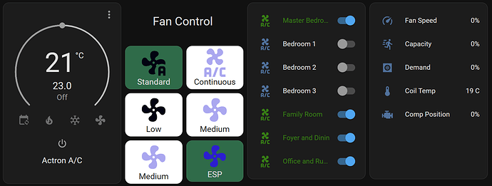

Hi, I am using the ICAMIB-MOD but guessing operation will be the same. I also used the NB114 after seeing your post . Got it working now. I would like to use the below register
Do you happen to know how to set this up?
Seems to be not implemented in modbus out of the box. I’ve done a workaround. Hope to improve the look … that will be for another day. Also there is a delay when the card status/color is updated. I read somewhere that the status is polled every 10s but there is a mechanism to poll straight away … that will be for another day too!!

Looking a lot nicer and more responsive!!
Next one is to implement timers. I want to be able to set run time (ie: 2 hours) or start/stop times. Essentially the controls that are available in the keypad … should not be too difficult but that will be for another day :slight_smile:
