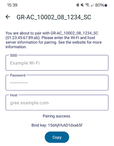

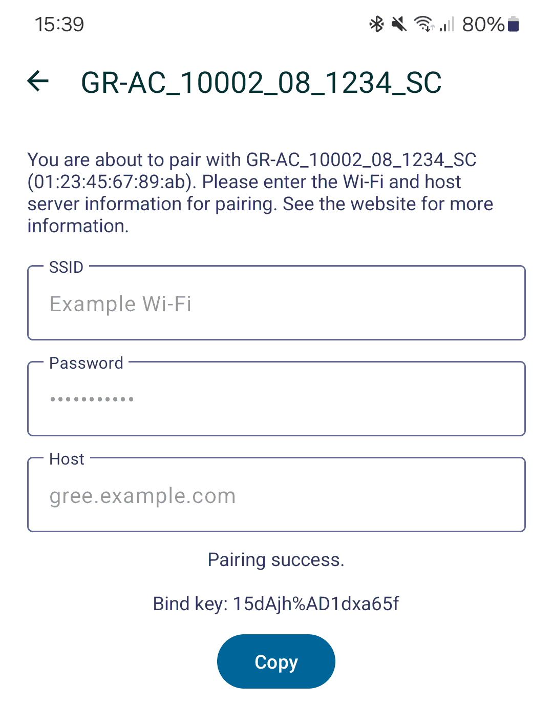

You can use the Gadgetbridge app to connect your Gree AC to Wifi without needing the official Gree app. It also outputs the bind key for you.
Ben,
No matter what I try I cannot get the Gadgetbridge app to connect to my Gree mini split. Can you by chance give me the steps you followed to do so?
Thanks!
I did read some Gree models only have WiFi and no bluetooth. If it doesn’t have bluetooth then using Gadgetbridge won’t work.
