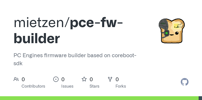

I forked the github repo and add a action to build the firmware. I also added a release of v4.11.0.6 to the repo, so if you trust me you may use this one.
I couldn’t compile a newer one. They all had linker errors, but the one above works… good enough for me :slightly_smiling_face:
