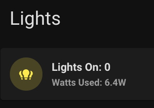

I am getting a phantom watt reading when all lights are off:
Here’s my template for this:
and when some of the lights are on…
… Also noticed even when a bulb is “OFF”, it shows a reading of 0.4 W (is this my issue and maybe just a residue/discharge of energy for zigbee?)
finity
May 24, 2022, 9:14am
24
I would assume it’s from the power draw of the smart plug itself (radio, LED, etc). Commonly called “vampire load”.
