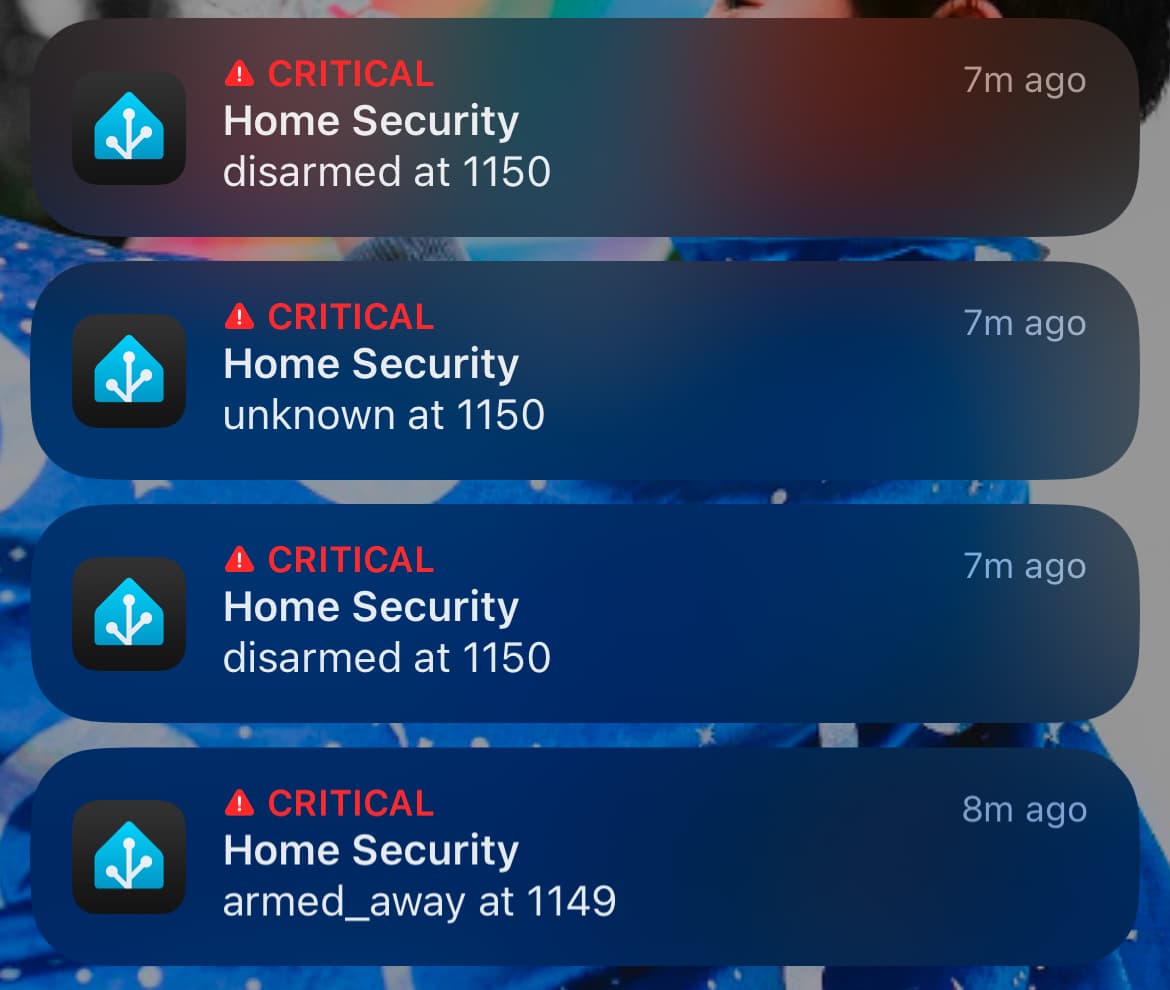

From the disarm state, I’m able to arm to any of the 3 other armed states. However, from the armed states, I am unable to ‘disarm’ though. Nothing in the system logs suggests there’s anything wrong with the yaml, my secrets file does indeed have a matching entry for the actual 4 digit code, is there anything wrong you can spot?
edit: I should also add that when I go into developer tools and then actions and use the following, it does work properly:

I can see that it will be in the ‘disarmed’ state and then for a short moment go to ‘unavailable’ or ‘unknown’ (and I’m not sure why it could be one or the other), and then once reconnected it would go back to being ‘disarmed’. is there a way to avoid the state change for these brief disconnects, aside from my end with the wifi?

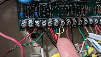

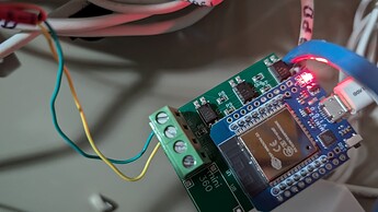

I’m still not getting anything on the bus. Something’s wrong and I must be overlooking it. I bought these ESP32s and soldered one to howardchen3’s PCBA. I’m using USB for power. The soldering came out well this time I don’t think that’s the issue.
I’m sure I’m missing something easy. I’d appreciate any help getting pointed in the right direction.

Your picture with the wiring is missing the black and red wires from the panel to the board
Yeah. I knew I was going to be embarrassed by the answer. I was so focused on figuring out ESPHome I didn’t check the hardware. Thank you for pointing that out!

What it hasn’t resolved though is that whenever the alarm status changes, something is still causing it to go into ‘unknown’ or ‘unavailable’ states. So here’s an example of what I mean:
While in ‘disarmed’ state, when I leave the house, it becomes ‘armed_away’, or vice versa when I return home. In HA, I have an automation that notifies me of the changes of the alarm state and I will see that it will go from ‘armed_away’ → ‘disarmed’ → ‘unknown’ → ‘disarmed’
I saved a log of when this happened and was about to post it, but can you advise if there’s anything I need to filter out because I’m assuming the disarm code is probably hidden somewhere in there?
Lastly, I also want to add that the shed in my backyard also has a door contact (which is part of the Vista alarm system) and an automation in HA will send a notification to me whenever the door opens every time. Not evident in the above example, but happens almost every time is that when the alarm status changes, I also receive a notification indicating that the shed door is also open (which I know isn’t).
I get the feeling that whenever that status change happens and causes the ‘unknown’ states, it may also be causing all the contacts of the system to go from ‘closed’ to ‘open’, before switching back to what the true state of it is. It’s just that the Shed door gives me a notification and so that’s easy for me to pick up.
Thanks for making it this far down into my post and sorry for the long winded writeup!
