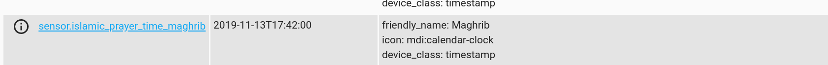

# Islamic prayer times integration
islamic_prayer_times:
calculation_method: mwl

sensor:
- platform: time_date
display_options:
- 'time'
- 'date'
- 'time_date'
- platform: template
sensors:
salah_fajr:
friendly_name: "Salah Fajr"
value_template: >
{%- set a = states("sensor.fajr_prayer").split("T")[1].split(":")[0] -%}
{%- set b = states("sensor.fajr_prayer").split("T")[1].split(":")[1] -%}
{{ a + ":" + b }}
salah_dhuhr:
friendly_name: "Salah Dhuhr"
value_template: >
{%- set a = states("sensor.dhuhr_prayer").split("T")[1].split(":")[0] -%}
{%- set b = states("sensor.dhuhr_prayer").split("T")[1].split(":")[1] -%}
{{ a + ":" + b }}
salah_asr:
friendly_name: "Salah Asr"
value_template: >
{%- set a = states("sensor.asr_prayer").split("T")[1].split(":")[0] -%}
{%- set b = states("sensor.asr_prayer").split("T")[1].split(":")[1] -%}
{{ a + ":" + b }}
salah_maghrib:
friendly_name: "Salah Maghrib"
value_template: >
{%- set a = states("sensor.maghrib_prayer").split("T")[1].split(":")[0] -%}
{%- set b = states("sensor.maghrib_prayer").split("T")[1].split(":")[1] -%}
{{ a + ":" + b }}
salah_isha:
friendly_name: "Salah Isha"
value_template: >
{%- set a = states("sensor.isha_prayer").split("T")[1].split(":")[0] -%}
{%- set b = states("sensor.isha_prayer").split("T")[1].split(":")[1] -%}
{{ a + ":" + b }}
