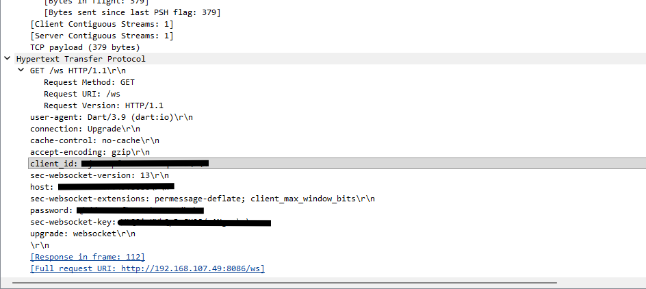

Additional Screenshot
Capture 2

Hey mate,
I think I may have figured something out for you.
  • Download nox player from https://www.bignox.com/. (I tested using v7.0.6.2).
  • Click around to find play store (I can’t remember exactly where I found it but it’s there somewhere. I will do it properly tomorrow and document in github).
  • Once signed in to google play store, download “myplaceiq”.
  • Click the cog (settings) at the top of the nox player window and go to the “device” tab. Check the “Enable network bridge mode” checkbox. You may need to install a driver. Leave all settings as is once enabled.
  • Restart nox player.
  • Open nox player, open myplaceiq and it should be able to find your hub.
  • Follow the rest of the instructions in the github to download and start wireshark and filter appropriately.
Let me know how you go and if it works, i’ll update the readme with better instructions for windows users.
Note: I couldn’t get Bluestacks or Mumu to work on Windows. Unsure why but probably due to architecture/app conflicts.
