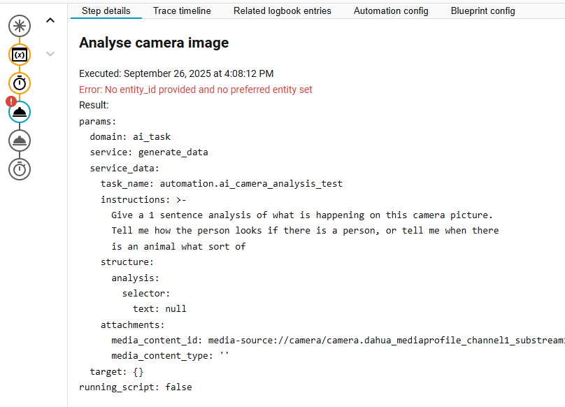

Im getting this error , tried to change some things in yaml but seems to stay, what am i doing wrong ? tried another sensor and camera also.
