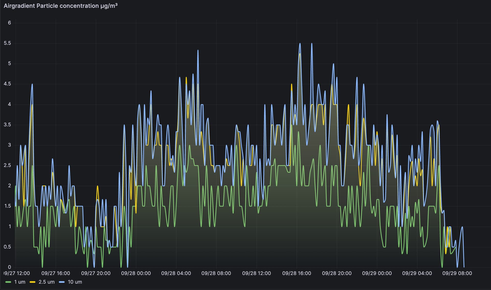

Hello
I place Airgradient right next to Vindstyrka and was monitoring particles concentrations. It looks like Airgardient reading are much more “noisier” Any idea why?
