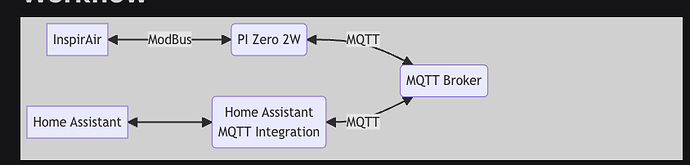

I have been working on an MQTT + ModBus based solution:
Might be helpful check it out at: hass-inspirair

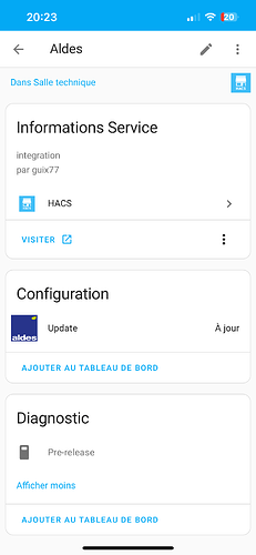

Hi team,
I’m new and the truth is that I don’t have much knowledge and I’m breaking my head. I have the model EASYHOME PureAir Compact CONNECT, I followed the installation steps, it asked me for the username and password, and nothing more, I can’t find the device. where am I making a mistake?

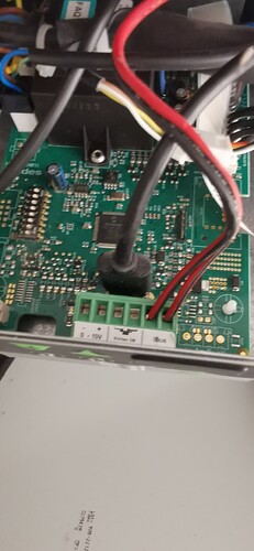

Hi Vadim, any pic, video on how to connect the modbus interface to the TTL RS485 board? Thanks
I have checked my machine.
I don’t have modbus interface… :cry::cry:
many thanks for your work, is it possible to use a USB-RS485 FTDI instead of PIzero2w ? (for someone not really experienced) Cheers
Hello! I also have a basic SC240 board with missing modbus port. But, as i see, only a few components are missing, that could be soldered easily.
They should be an rs485 tranceiver (U5), a jumper (J21), maybe a fuse (FU2) and some resistors (R84,R85,R87). Anyone out there that could take a picture of such components or has their names/values?

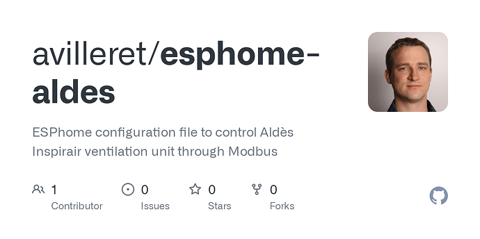

I’ve just uploaded my Esphome configuration files here :
It uses modbus to control Aldès Inspirair units (Side & Top).
You need to hook up a ESP32 board with a UART to RS485 converter.
Then you access your unit through home assistant locally, no cloud service involved.
Cheers
