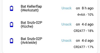

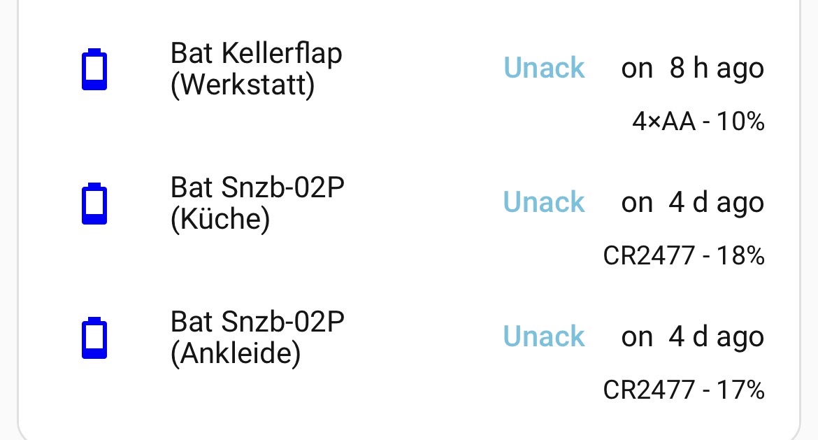

True. So basically I would be happy with info. I started using templates in the priority field, as superseds seemed complicated to me (to just bump the prio) Window open= info. Window open longer than 10 minutes = low. Raining outside= medium. And high is reserved for the leak sensors and such.
What I sometimes dislike is the sorting indeed. The lowest battery should go first. I would have used a formula to map prio of batteries, maybe not that end user friendly.

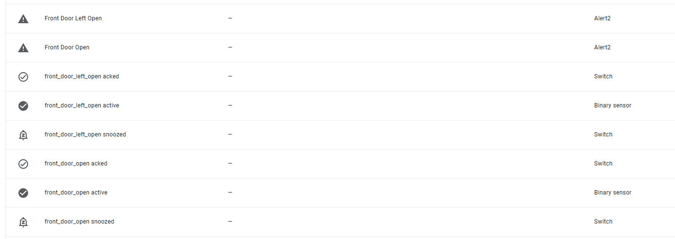

If you want to look at the proxy entities, you'll find them in entities.py, line 2419 et seq. (hass-alert2/custom_components/alert2/entities.py at b26bb204c4e218def1d13c22904508ecb8c9d121 Ā· cerebrate/hass-alert2 Ā· GitHub), a base class and three subentity implementations, a binary sensor and two switches per alert.
No, I’m looking at the right place. Binary sensors are what cause ā€œalertsā€ to be usable in Alexa. Your code needs to create a binary sensor. It’s not, so you aren’t getting the functionality you want.
With all due respect, as the writer of the code in question and the one who is running it on his Home Assistant instance at this moment, I think perhaps I'm the authority on how it works.
And, well:
Behold! Binary sensors (and switches), just like I said it created!
