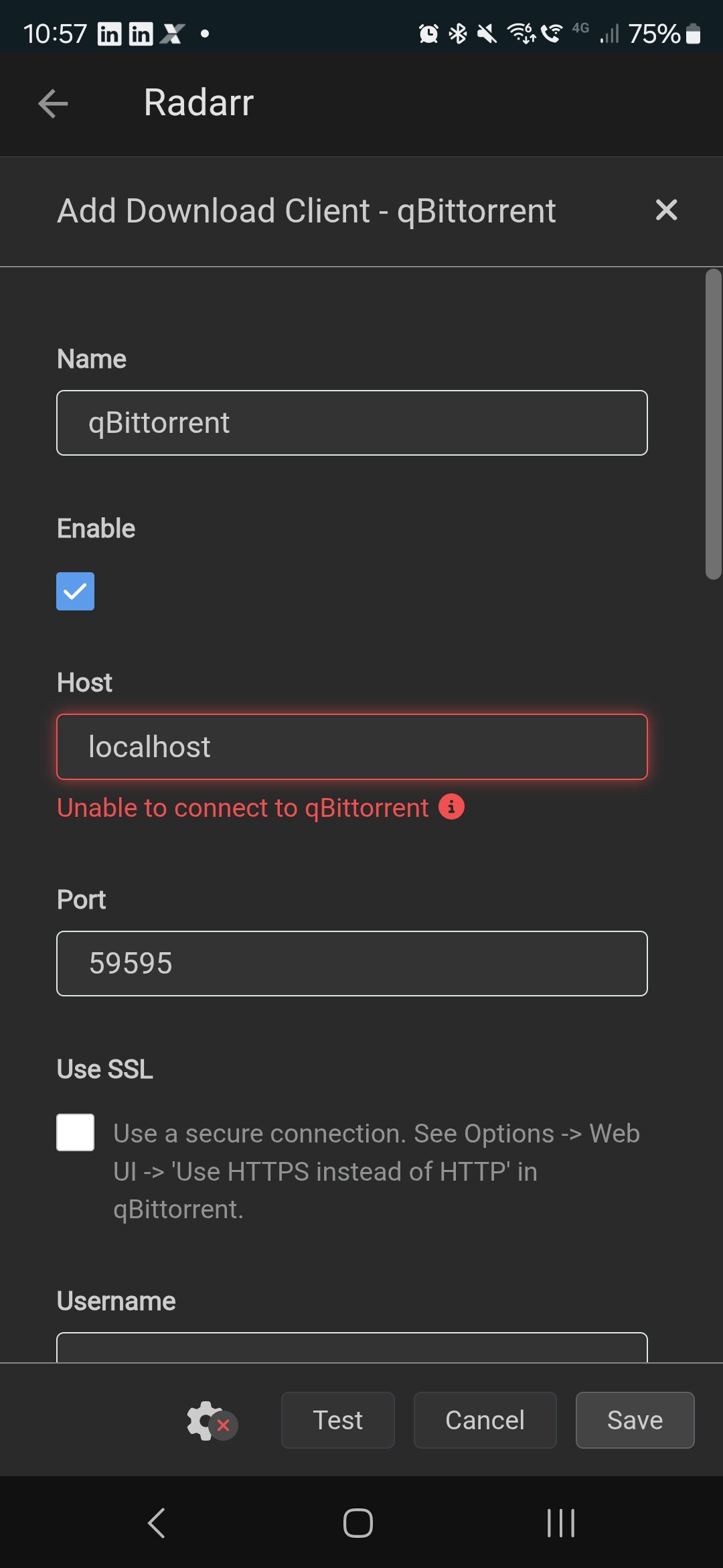

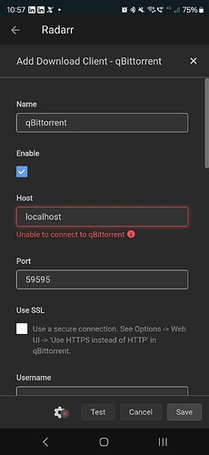

@alexbelgium is there any tutorial on how to config qBitTorrent with sonarr and radarr? I try to add it on sonarr and I get a error on localhost.

You need to use the Hostname of the Add-on instead of localhost.
It is shown on the Add-on page inside Home Assistant.
