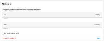

ports:
  443/tcp: 443
  80/tcp: 80
  8080/tcp: 8080

Give it a few minutes and then install within the ‘Add-on Store’ under local add-on
