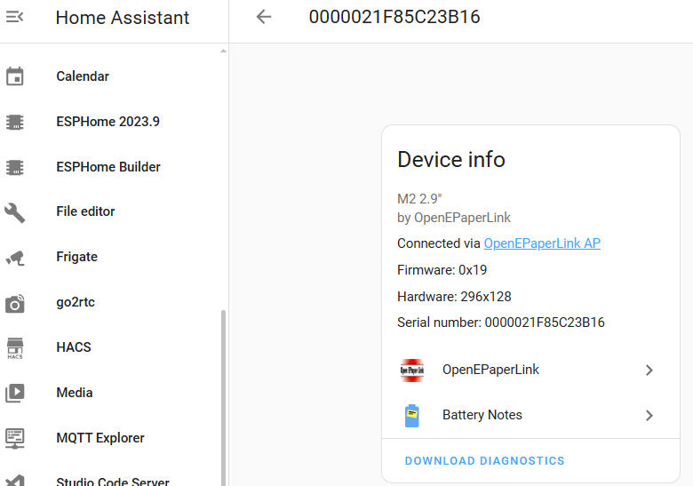

Since the last update to open_epaper, I have been unable to send data to my ePaper displays.
Here is a script that I used to test the displays a year ago:
alias: ePaper Test
sequence:
  - target:
      entity_id:
        - open_epaper_link.0000021F85C23B16
      background: white
      rotate: 0
      payload:
        - type: line
          x_start: 0
          x_end: 296
          y_start: 0
          y_end: 128
          width: 1
          fill: black
        - type: line
          x_start: 296
          x_end: 0
          y_start: 0
          y_end: 128
          width: 1
          fill: red
    action: open_epaper_link.drawcustom
mode: single
When I run the script, I get this error:
“Failed to perform the action script/epaper_test. ‘NoneType’ object is not iterable”
I saw this in github: “Service target now uses device ID instead of entity ID”
Here is my device information:
And my modified script:

a serial number is not a device_id.
Read this issue on GitHub: https://github.com/OpenEPaperLink/Home_Assistant_Integration/issues/224
Thanks- I read the breaking changes on GitHub but never saw the page you referenced.
Also, since posting my question I found an easy way to get the device_id:
