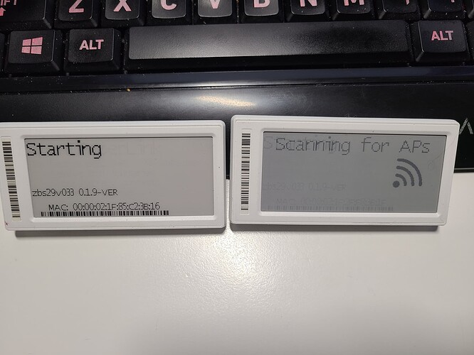

Are my tags bricked?
I put batteries into two more tags and this is what I see:
Neither appear in the AP
ap
Any tips to how I can fix this?
try resetting them again by shorting the battery contacts.
See this link OpenEPaperLink/Hardware/OpenEPaperLink Mini AP/Getting Started.md at master Ā· jjwbruijn/OpenEPaperLink Ā· GitHub
Thanks for the quick reply. That’s what I did on the one showing ā€œScanning for APsā€, but I did it again and both additional tags are working.
