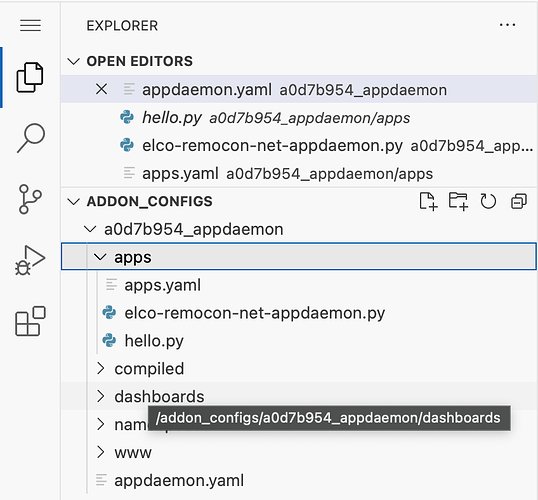

Unfortunately I don‘t use NS Panel. But check if the apps folder in the add_configs folder has the necessary .py files of that App (NS Panels) With my use case (Heating) the relevant .py file was not automatically copied to the addon_configs folder i.e. remained in the config folder. After copying the .py file to the addon_configs app folder and ensuring that the apps.yaml in the addon_configs folder is mounting the app, it worked again. The following pictures as a visual help to what I wrote :grinning:
