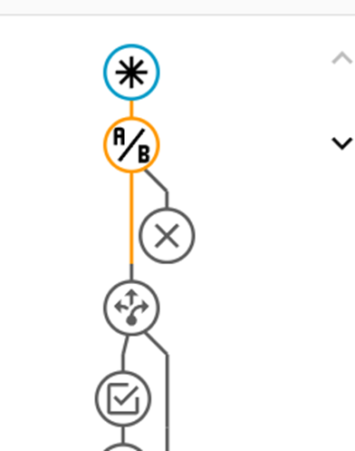

I started over and it still doesn’t work. Not sure what I am missing? The Input end helper never updates.
It stops at the first step.
The new yaml file
