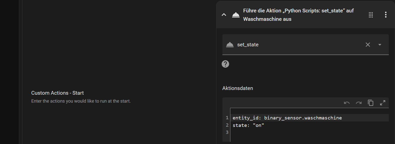

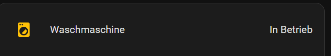

This blueprint can do anything you can imagine - thank you Blacky, once again I can discover one of your works. :smiley:
For the display in the dashboard, I’ll try a helper (binary_sensor.waschmaschine), which should be switched on and off at the start and end of the wash cycle.
Result should be:
I’m curious to see if everything works, so far I’ve only executed individual actions directly in the blueprint once (have nothing to wash right now :grin:), but everything seems to be okay. :slight_smile:
I also receive notifications on several Echos, but these voice messages are not sent simultaneously but one after the other with a noticeable delay. The latter is probably unavoidable, isn’t it?
Many thanks again!

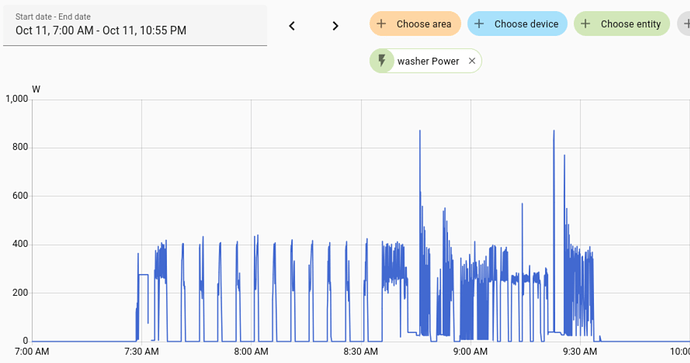

Hi @Blacky! First thing, thanks for the wonderful blueprints. I’m using some of them, and they are AMAZING!
I’m writing this message to reach for help. Right now my appliances trigger the automation, and I can see the start notification; they increase the cycle count and change the run status, and yet I can’t get the end notification.
Like, this is the power graph for my washing machine:
You can see those drops in the energy from time to time during the first hour. It’s normal; the machine runs for a minute and then stops for no more than 10 minutes and repeats this for some time.
So, I’ve set the Running - Dead Zone to 10 minutes.
The End - Power Time Delay is set to 5 minutes, which is the max value available.
Could those two values be the source of my issue here?
Anyway, I’m pasting my config here in the hope that I could receive the end notifications that I’ve been waiting so much :sweat_smile:

The running dead zone is from when it starts. So say it started at 7:30 the automation wont look at any energy readings for 10 min until 7:40. Normally this will always be set to 0 but in some cases you may need to have a dead zone.
All the dips during the start to the end… what are they and what is the lowest reading?
Say you lowest reading is 1 watt. Then you could type in 0.5 watts if you like in your End - Appliance Power Setpoint. As long as the end goes from above 0.5 watts to below 0.5 watts for your End - Power Time Delay you will receive the end notification.
If the lowest reading during the cycle is 3 watts then you can set the End - Appliance Power Setpoint to 2 watts.
With All the settings, you can type the value in. So for you End - Power Time Delay only goes to 5… you can type in 8.5 if you like. Personally I try to get the End - Power Time Delay down as low as possible (under a minute) so when it finishes you get notified quicker.
Blacky :grinning:
The dips are moments that my washing machine stops, waits for some time, and then works again. A kind of ā€œquick soakā€. During that time the reading goes to 0.
Thanks for clarifying the Dead Zone behavior. So, it only works right after the start and not during the entire program, right?
I don’t know if my socket can read anything under 1 watt.
I’ve changed the configs here. Let’s hope it works on the next laundry.

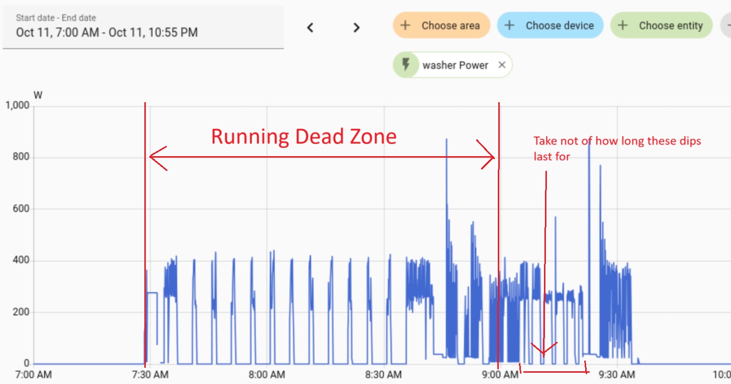

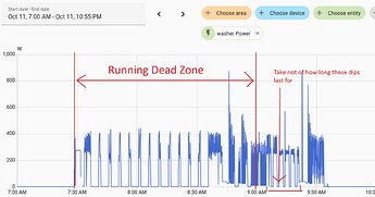

Aha, that helps. So you’ll need to decide if this normally happens during a cycle. You could set a running dead zone of about 90 minutes, which would cover the period from the start to the 9 a.m. mark on your graph. This will disregard that part of your cycle.
Next, take note of the dips shown on the graph and see how long they last. Let’s say they’re about 2 minutes 40 seconds at most… in that case, set your End - Power Time Delay to 3 minutes, or slightly less if you prefer, but no less than 2 minutes 50 seconds. See below. Then reset your cycle count to 1.
Edited code for you.
