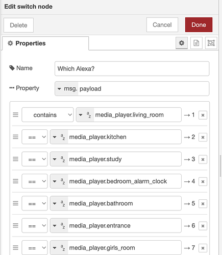

If you’re using node_red, then use an event: state node that is looking for a change in state of the input_buttons that get pressed when use Alexa. For example, when you say “Alexa, turn on the tv” , it triggers a routine that presses the input_button.room_aware_tv_on button that you created. The node red flow detects that, and use that as a trigger.
Here’s a picture of the front end of my flow:
and here’s is what the “Room Aware” events:state node looks like:
and here is what the “button?” switch node looks like:
and here is what the “which Alexa?” switch node looks like:
