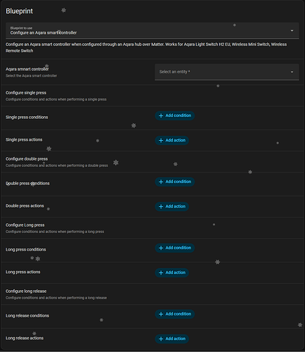

I have created a blueprint automation that does all the logic and conditions. Based on device type (if it also supports double/long press) it will automatically select between initial_press or multi_press_1.
You only need to select the entity, any additional conditions (optional) and actions for each type of press. You only need to fill the conditions and actions of the press types you want to configure.
You can find my blueprint here:
