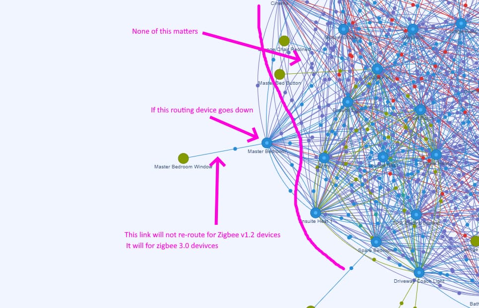

so if i’ll change my skyconnect key i’ll have to reconnect all the zigbee devices?
i learnt something new also today, thanks
No that’s nothing to do with what I’m talking about.
The problem is the route stored on the device.
Depending on if you are using ZHA or Z2M you may not have to re-pair e.g.
https://www.zigbee2mqtt.io/guide/faq/#what-does-and-does-not-require-re-pairing-of-all-devices
Switching between adapters requires re-pairing, except when:
- When the
serial.adapter
in theconfiguration.yaml
iszstack
orember
and theserial.adapter
stays the same; e.g.zstack
→zstack
re-pairing is not required.
so basically it’s a multi-hop use case where one of the hops becomes unavailable and does not come back online?
well not that common, is it?
Again. No. Only the first hop from the device. The routers it joins to should be capable of re-routing. Only it can’t.
EDIT: Here, perhaps this explains it better, read from top to bottom:
