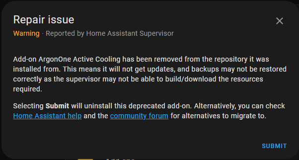

Argon One Active Cooling removed from HA Add-In repository. Where now? @adamoutler
It still works, so I’m keeping it installed for now.
All the add-ons are still here. I don’t know why you’re not seeing them.
I see this Repair on my Settings Page - and don’t see the add-ons on the store???
Maybe you removed the repository?
It isn’t anything I’ve changed.
I’m running a Supervised installation. It all worked fine until I updated the core to:
  • Core2024.12.0
  • Supervisor2024.11.4
  • Operating System
  • Frontend20241127.7
(I’m currently running Core2024.12.2)

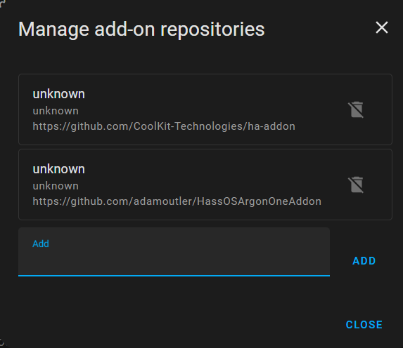

My repository configuration looks like this:
It won’t let me remove your repository because it is still in use but the Community Repository list has nothing beginning with ‘Argon’
(I wanted to include a screen clip here but I dont have sufficient privilege to include more than one .png per post)
Of interest - the EweLink (CoolKit-Technologies) add-on has also suffered the same fate.
My guess (and it is a guess) is that it has been deprecated from the Supervised installation but not the HassOS configuration. This surmise is based on the observation that you are not aware of any problem. What’s your opinion?
Mark
@adamoutler Hi Adam - thanks for your gentle prompting. I have now worked out what is happening. The issue was rooted in DNS. hassio_dns was unable to resolve github.com vie the DNS on my router. I re-configured it to use the google DNS resolver and everything has come back to life.
Now I need to work out WHY - but that is a story for another day. Thanks again.
Mark
