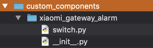

@ hekm77 I saw your branch link as well as the “switch” code that you have so kindly provided but I am really not familiar with coding, so I would really appreciate your help in order to properly configure my HA to work with the aforementioned automation based on your custom component. What I have done so far is created a folder called “custom_components” under the config folder, then added another folder inside the “custom_components” one and called it “Xiaomi_Alarm” and then I downloaded the two files indicated inside your branch and put them inside the folder “Xiaomi_Alarm”. Afterwards, I have placed the code for the “switch” inside the configuration.yaml file of HA and restarted everything (I don’t think that the restart really took place). After all those steps I believe that there are a lot of things still missing, since my config doesn’t seem to be “Checked OK” upon inspection but also the HA doesn’t seem to be restarted after all. Also, there is nothing inside the “Overview” tab to indicate that there is a new switch with which I can interact. Please I would like from you as well as everyone else that can help, to instruct me step by step, if possible, on the steps and things that need configuring so that this custom component automation becomes functional. I am really sorry for the long post. Thank you in advance!

So if I just change the name of the folder from mine “Xiaomi_Alarm” to yours “xiaomi_gateway_alarm”, it should be working? Please note that the “switch.py” and “init.py” are indeed as you illustrate in the image. Is there anything else that needs to be done afterwards? Will I be able to see something new inside the “Overview” tab?

Yes, it works.
The folder should be named xiaomi_gateway_alarm
It contains files from github, switch.py and __init__.py
Add the code that is a few posts above in the configuration.yaml and specify the host and token of the Xiaomi Gateway.

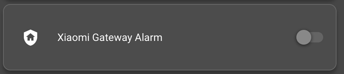

After rebooting Home Assistant, you will have a new entity switch.xiaomi_gateway_alarm
Use this switch to arm / disarm.
Ringtone, volume, delay is set in MiHome app.
If you arm / disarm from the MiHome app, the switch status in the Home Assistant is updated after 10-15 seconds.

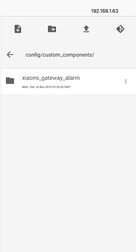

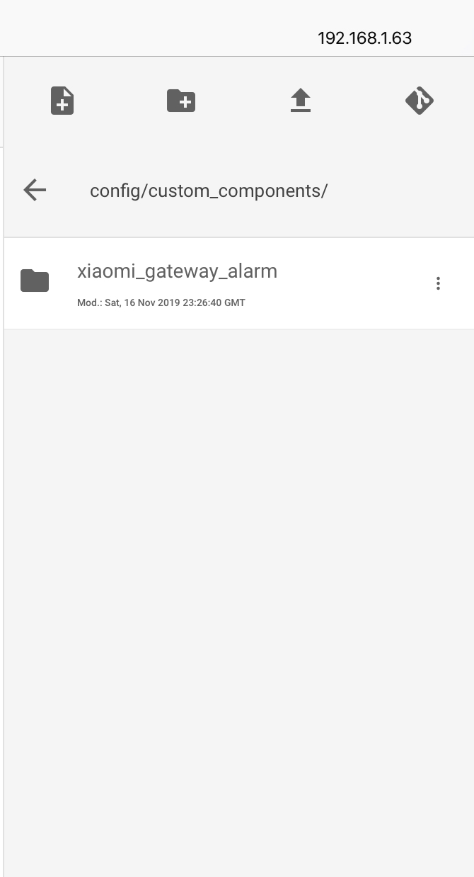

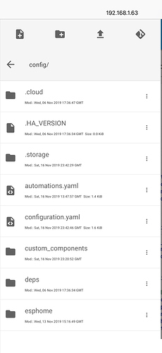

I’m quite crazy trying to add arm/disarm switch, i added some screenshots with files created and after reviewing it 20 times, it doesn’t work. This is the message:
2019-11-17 00:43:38 ERROR (MainThread) [homeassistant.components.hassio] Platform error switch.xiaomi_gateway_alarm - Integration ‘xiaomi_gateway_alarm’ not found.
Thanks, You are right!!! I introduced gateway token and I works
