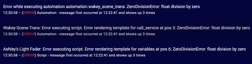

I continuously get “float division by zero”. I’m using the 2.0 script already.

Any ideas please?

Hi there. I tried to implement the Skript Toma simple automation. But my lamp behaves odd. It starts the automation with a delay of a few seconds. Then it turns on the light and raises the light intensity to max within a second and then it turns of.
Do you have an idea where this might come from?
Thanks in advance
