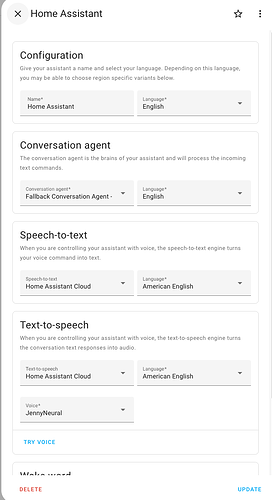

My apologizes for asking for help but I’m a little stuck here… My OpenAI assistant works (using OpenAI Conversation) and my HA assistant works but when I set the Fallback Conversation Agent as the default Conversation agent I get the error below
Core - 2024.5.3
Supervisor - 2024.05.1
Operating System - 12.3
fallback_conversation - v1.0.2
Debug Log: 2024-05-16 13:44:17.158 ERROR (MainThread) [homeassistant.components.assist_pipe - Pastebin.com
Screenshot 2024-05-16 at 2.19.10 PM
Absolutely no reason to apologise for that! You need to unplug and decompress every now and then. Ive been there…
You set your primary conversation agent to the Fallback conversation agent from the looks of it, which causes it to be called recursively. I think because you called it “Home Assistant”, you picked the wrong one.
I called it “Fallback Conversation Agent Test 1” but I assumed in the Fallback options you wouldn’t select that and you’d want “Home Assistant” setas the primary for HA stuff and “OpenAI Conversation” for all the other silly stuff.
I did I set it as “Fallback Conversation Agent Test 1” in the Voice Assistants menu under “Conversation agent”
Screenshot 2024-05-17 at 4.34.57 PM

As you can see calling local voice assist is fine but calling openai is failing.
My voice assist looks like this:
When calling openai directly it works:

Oh, huh… I must have gotten confused I guess because the name of your pipeline was “Home Assistant”, sorry about that.
I suspect because of these lines:
2024-05-16 13:44:33.102 WARNING (MainThread) [homeassistant.components.conversation.agent_manager] Conversation agent <custom_components.fallback_conversation.FallbackConversationAgent object at 0x7fb76e13d0d0> is still loaded after config entry removal
There may be something misconfigured. Have you tried restarting Home Assistant?
But beyond that, I am not sure, it’s hard to tell.
Do you have debug logging on, can you share system logs related to it as well?
Odd that it would behave this way.
Also, could you set debug level to Verbose and see what the responses are? This could potentially help. Also, what is your Fallback Agent’s settings looking like?
This is weird, I’ve not seen this behaviour before.
Setting my debug level to verbose doesn’t seem to show much:
Here are my logs with debug enabled on your integration and openai:
2024-05-21 22:19:12.386 WARNING (SyncWorker_0) [homeassistant.loader] We found a custom integration hacs which has not been tested by Home Assistant. This component might cause stability problems, be sure to disable it if you experience issues with Home Assistant
2024-05-21 22:19:12.386 WARNING (SyncWorker_0) [homeassistant.loader] We found a custom integration nodered which has not been tested by Home Assistant. This component might cause stability problems, be sure to disable it if you experience issues with Home Assistant
2024-05-21 22:19:12.387 WARNING (SyncWorker_0) [homeassistant.loader] We found a custom integration fallback_conversation which has not been tested by Home Assistant. This component might cause stability problems, be sure to disable it if you experience issues with Home Assistant
2024-05-21 22:19:12.387 WARNING (SyncWorker_0) [homeassistant.loader] We found a custom integration adaptive_lighting which has not been tested by Home Assistant. This component might cause stability problems, be sure to disable it if you experience issues with Home Assistant
2024-05-21 22:19:19.636 WARNING (MainThread) [homeassistant.helpers.frame] Detected that custom integration 'hacs' accesses hass.components.frontend. This is deprecated and will stop working in Home Assistant 2024.9, it should be updated to import functions used from frontend directly at custom_components/hacs/frontend.py, line 68: hass.components.frontend.async_register_built_in_panel(, please create a bug report at https://github.com/hacs/integration/issues
2024-05-21 22:19:26.365 WARNING (MainThread) [homeassistant.helpers.frame] Detected that custom integration 'hacs' accesses hass.helpers.event. This is deprecated and will stop working in Home Assistant 2024.11, it should be updated to import functions used from event directly at custom_components/hacs/base.py, line 630: self.hass.helpers.event.async_track_time_interval(, please create a bug report at https://github.com/hacs/integration/issues
2024-05-21 22:22:09.339 DEBUG (MainThread) [custom_components.fallback_conversation] Processing in en using conversation.home_assistant with debug level verbose: turn on bedroom light
2024-05-21 22:22:15.102 DEBUG (MainThread) [custom_components.fallback_conversation] Processing in en using conversation.home_assistant with debug level verbose: nz tallest building
2024-05-21 22:22:15.185 ERROR (MainThread) [homeassistant.components.assist_pipeline.pipeline] Unexpected error during intent recognition
  File "/usr/local/lib/python3.12/site-packages/homeassistant/components/assist_pipeline/pipeline.py", line 994, in recognize_intent
    conversation_result = await conversation.async_converse(
  File "/usr/local/lib/python3.12/site-packages/homeassistant/components/conversation/agent_manager.py", line 87, in async_converse
    return await method(
  File "/config/custom_components/fallback_conversation/__init__.py", line 90, in async_process
    agent_names[agent_id],
KeyError: 'conversation.openai_conversation'

Just one idea, without checking the code:
Did they change anything in the default Home Assistant agent how unrecognized intents are handled?
The fallback integration assumes that the primary agents returns a specific error object in case the intent was not recognized. Then the fallback mechanism kicks in.
For me the screenshots look like that the HA agent prints the red error message and then responds with a valid (but wrong) answer „turned off the light“. And for the fallback agent it looks like that the primary HA agent handled the intent successfully.
Or am I wrong?
