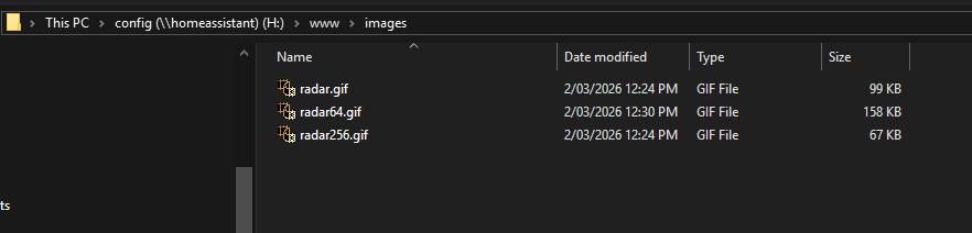

I had a few small issues to get this to work, but it’s up and running now. I also ended up placing on a tabbed card with the 64, 128 and 256 km radars.
There’s 2 additional .py files created, one for each additional radar range pointing to two additional .gif files

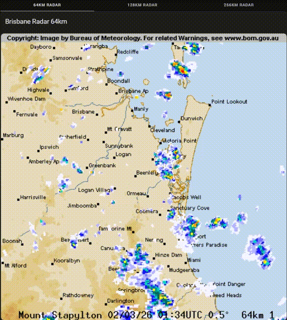

The result
radar

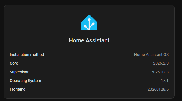

Technical Note
This refactored integration was tested and validated on a Home Assistant instance deployed within a VirtualBox guest VM running on a Windows host. The synchronous implementation is particularly beneficial in virtualized environments where executor-based async operations can introduce additional latency and context-switching overhead. Direct blocking I/O operations via FTP reduce the complexity of inter-VM communication and improve reliability compared to the async/executor pattern on this type of hypervisor configuration.
