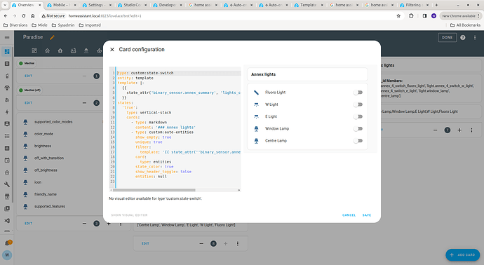

which works fine and produces an entities card, like so:
However I want to produce a grid of tile cards (or mushroom cards), but my inability to think and speak yaml and jinja prevents that. I have tried several different possibilities gleaned from the posts of others, but canât crack it. Any and all help would be greatly appreciated.
