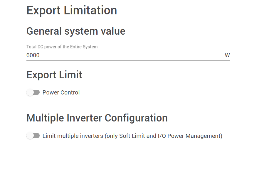

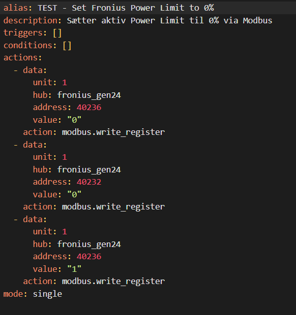

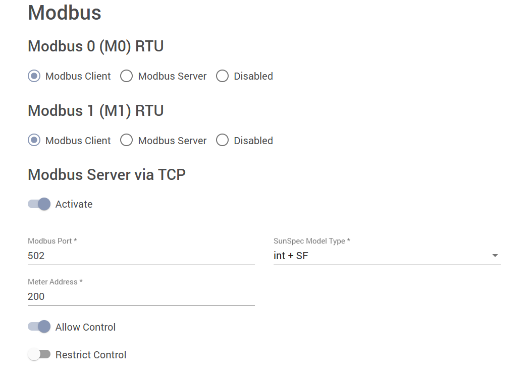

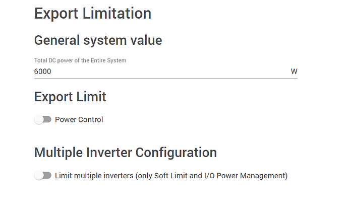

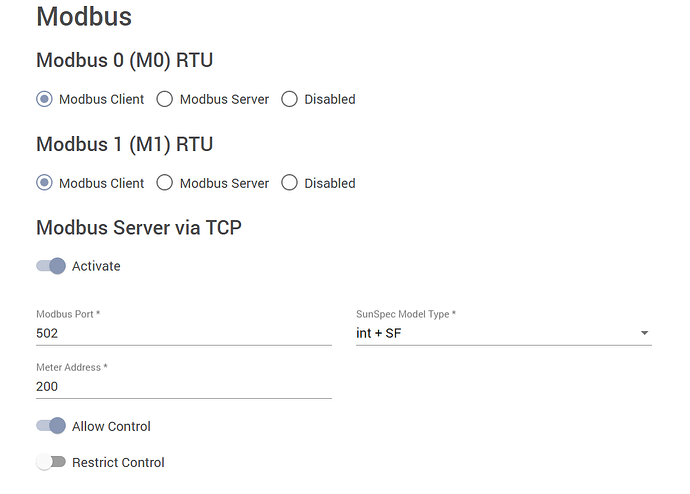

My installation consist of a Fronius Gen24 6kW + Smart meter + BYD battery.
I’m trying to find a dynamic way to limit the feed-in to the grid during negative feed-in prices, just like the function available in the user interface under Export Limitations, “Maximum Grid feed-in power”, which works great, but requires me to manually turn on/off hour by hour.
I have tried to follow the examples in this thread but without succes.
Maybe someone would take a look on my configuration:
The Modbus interface is working - I can read values and using a Modbus tester I can se the values are correctly send from the automation. But I get no reduction/change in the feed-in effect to the grid or the produced effect from the Inverter.
Actually the only reaction I have seen is that a Battery Management Rule with max charging power of 0W is being ignored and the battery is getting charged.
I must have missed something?
